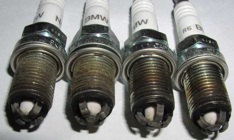

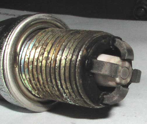

OK, plugs are changed to the IK22's. I'll do another run on the way home. Temps will be about 15 deg hotter and humidity is about 100% today.
Here are the stock plugs after 3000 miles. 1500 stock, 1000 with an intake and pulley, 500 with intake, pulley and MTH:
Attached Thumbnails Timing pull questions-plugs1.jpg   Timing pull questions-plug2.jpg

Well, with the plugs switched to the colder IK22's, and the weather about 15 deg hotter (85) and humidity in the upper 90's, there is absolutely no difference from the stock plugs, with a JCW intake, 15% pulley and MTH software. Butt-dyno says identical, logs show the same readings.
At least the plugs were cheap, and I have perfectly good OEMs to put in when these wear out.
