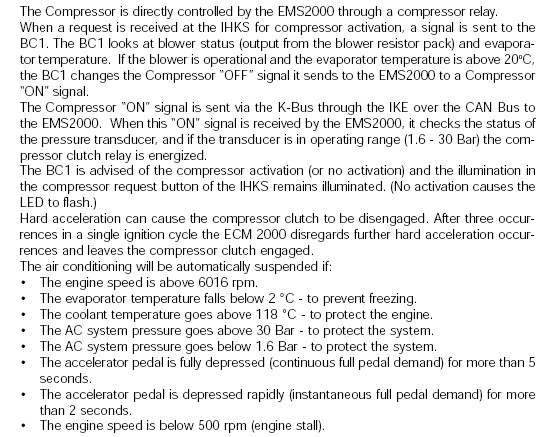

I cannot confirm it by experience - but "MINI Complete" says that it can happen in some circumstances (see attached).
But MINI Complete was created back in 2002 and may not be accurate now.

I think I do believe it. It says the AC compressor will disengage if: the throttle position changes abruptly to full throttle and stays there for more than 2 seconds, or full throttle is maintained for more than 5 seconds.
Assuming we quickly go full throttle, 2+ seconds is a long time, certainly enough to have had quite a detrimental effect on throttle response. And if you have to go through the 5+ second delay, you may as well give up hope.
With this in mind, manually turing off the AC is the only sensible approach for performance driving, especially if maximum acceleration is desired.

eMINI may be on to something. JCW's are most of the way through first gear within 2 seconds, so by the time the A/C is ready to shut down we're shifting into 2nd and the 2 second delay starts over again. I have noticed full power come back half way through second gear. I wonder if we can get the OEM chip or a GIAC reprogrammed to reduce the the delay time.
