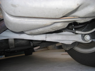

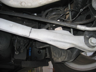

I was installing the rear fog light and looking around under the car when I saw a crack in the right rear control arm. Only one side is cracked that I can see. What can cause this.
This must be defective, I dont race, I drive winding roads near my house but only once have I felt the dsc come on. I did hear a clunk about a week ago but all I was doing was backing out of my parking spot at work. I know this wasn't there when I got the car since I remember looking underneath. What type effect would this have on driving, and is it safe to drive the car to the dealer for repair, approx 20 miles? This should be a warranty repair right?? Thanks for any help.

Several people have had them break, I have seen the pictures here or at MINI2. I definitely would not drive until fixed.

Yep, there have been three or four known occurrences of this. I would call Roadside Assistance and have it picked up. This will be safer and let the dealer know you consider this to be a serious problem.

..... and they all seem to be that same lower on the right side. Note that they are breaking accross where those holes are.

Interesting location of the crack. I believe after 03, the control arm had solid holes. My open hole control arms were replaced with arms w/ solid holes...(my replacement control arm has the solid holes) yet the crack occurs at the same spot. The reason my control arm is so bent is that I continued to drive not knowing that a crack was in place and continued hard cornering bent the @#$% out of it. Have it towed to the dealer. Again let us know what happens. I would be curious to find out if yours is replaced under warranty, and if so if MINIUSA would refund the $$$$ I paid for replacing a defective part.

Thanks for everyone's help. I am having MINI tow it to Bob Smith MINI tomorrow morning. I'll keep you updated on the result.

Yes the repair was done under warranty by Bob Smith MINI including wheel alignment. No problems - done the same day. I was prepared for a fight but they stated since they could find no damage that may have caused the crack that it would be a warranty repair. So far so good with this dealer, of course no loaner since I didn't purchase my car with them. Good luck.
