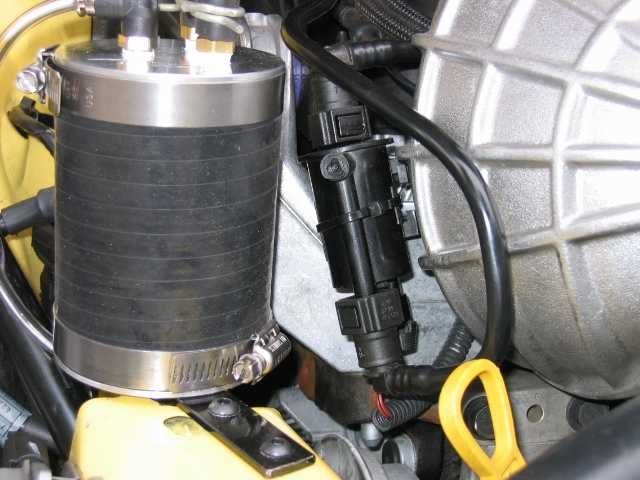

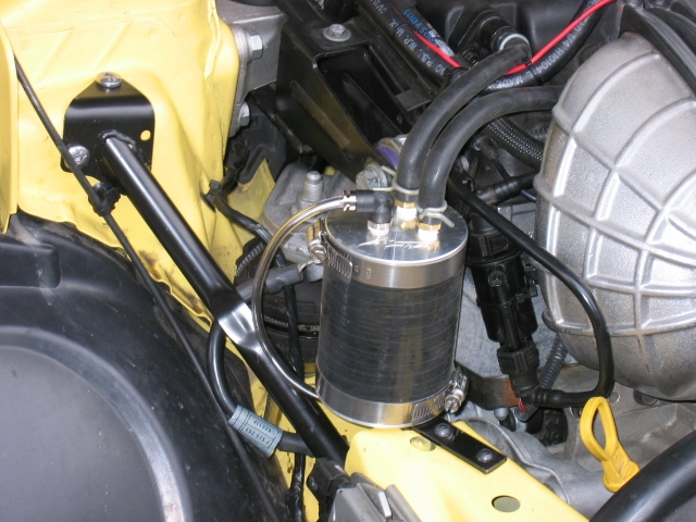

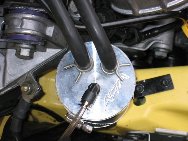

This oil catch-can / oil separator thread is full of information and motivated me to install a catch-can, which I had delayed for 3 years. The thread resolved the question of the optimal hose conections, provided ideas as to mounting the catch-cn in the cramped engine compartment and provided other practical advice.
I decided to connect the catch-can in series with the PCV valve and the low pressure side of the throttle body. The catch-can will see vacuum with this arrangement. I decided to purchase the Alta catch-can because of it's small size and I've been happy with their other products. Jeff, at Alta, understood my concern about vacuum and the catch-can and incuded, with the catch-can kit, two large metal rings to place inside the silicone hose body of the catch-can. These rings will keep the catch-can from collapsing under vacuum. Inside the catch-can I placed, in a ring like arrangement, three stainless steel springs, similar to the old SU carb springs, and stuffed a copper turnings pot scrubber at the bottom. All this metal is to provide a large surface area for the suspended and vaporized hot oil to condense.
Mounting the catch-can was easy, even with '05 convertible tower braces retrofitted in my '02 MCS. The goal was to mount the catch-can as close as possible to the PCV valve to minimize hose lengths. To do this, it is necessary to move the black gas tank vent assembly as far toward the center of the car as it will go. All that was necessary was to shorten the stock bracket by 2" and to anchor the gas tank vent assembly to the stub of the bracket with a plastic cable tie. Moving the gas tank vent assembly out of the way provided plenty of room to locate the catch-can in that space right next to the motor mount, the gas tank vent assembly, and the supercharger outlet ducting and away from the headlight assembly in the hood. The bottom of the Alta catch-can was drilled and tapped to attach a mounting bracket fabricated from a 1/8' x 3/4" x 6" length of hardware store aluminum stock. The catch-can and bracket assembly is bolted to the frame rail in which threaded steel inserts for M6 fasteners were installed. Large self taping screws might work as well if they aren't removed very often.
So far, so good. Did clean the oil out of the intercooler with paint thinner. Too soon to tell how well the catch-can is functioning. I'd think that anyone could mount their catch-can as I did if they are willing to shorten the stock metal gas tank vent assembly bracket and are willing to drill two holes in the frame rail.
