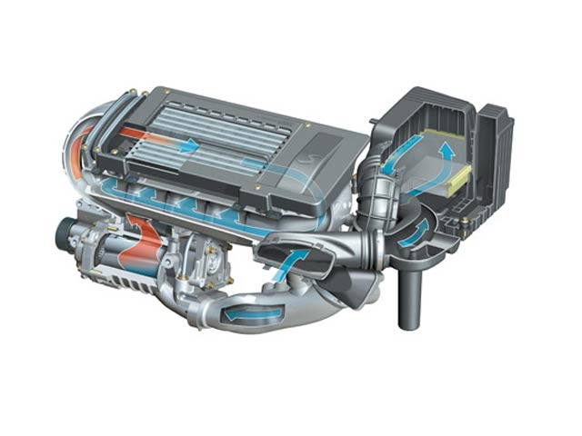

My 05 MCS is the first supercharged engine I have owned. To be honest I had never heard of an intercooler prior to last December. This could be considered embarrassing since I'm 56 - but whatever! Wikipedia tells me what the intercooler does and I understand the physics, but I wonder if anyone knows of a graphic (blown apart?) diagram of the MINI engine so neophytes like me can see in some detail what is going on and in what order? Thanks for any help!
Don't mean to subvert the thread here, I'll start one if thats a problem.
How about this.........
Attached Thumbnails Oil Catch Can-ghost-alta-intake.jpg   Oil Catch Can-intake-ghost-image.bmp
Thanks Scott - that should help a lot.
