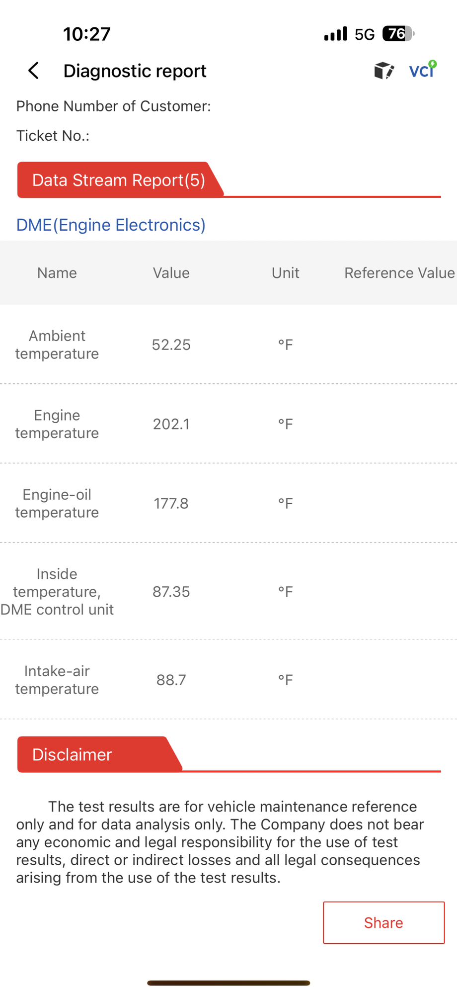

yes. It’s the foxwell/schwaben… and there’s nothing other than what I’ve already described other than headlight fault codes.
everything keeps coming back fine.

Originally Posted by Maybe, maybe not
Possible DME issue?
that’s what I’m suspecting.
I’m going send it out to get tested.
for some reason I don’t think it should be -54 degrees
and with everything swapped out multiple times… it’s gotta be
and because of the thermostat not opening correctly? It boils over. Vacuum it down it hold pressure more than 48hrs. So computer is the leading indicator
