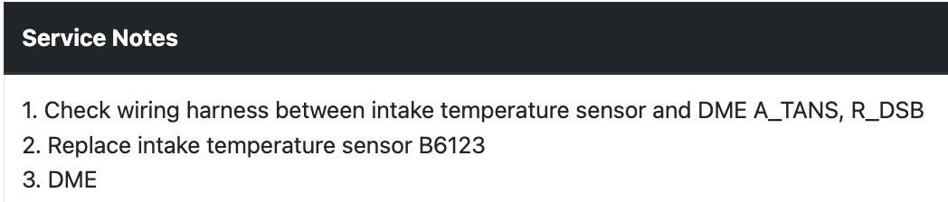

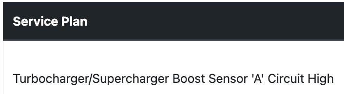

The two new codes are interestingly for a dual sensor consisting of the intake air temperature sensor and the boost pressure sensor.

Is your scan tool reading -40C for the IAT sensor? If so, in this thread read the first post and also netstable's posts and mike1967's replies to netstable.

The car has thrown 4 intermittent fault codes, 2 for the MAF sensor, 1 for the IAT sensor, and 1 for the boost pressure sensor (all three sensors have been replaced).
One of the MAF sensor fault codes is a plausibility issue with air flow too high.
All three of the remaining fault codes above indicate electrical issues.
