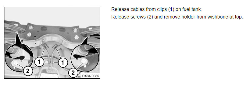

I'm looking for the part number to replace the plastic parking brake cable clips that hold the cable to the frame above the fuel tank. I've looked through the parts diagrams, but cannot for the life of me find those clips.

Nope, its not that clip, which I think is why I can't find it...
I just found reference in the instructions! Item #1 in the following diagram:
I just can't seem to find the reference in the parts diagrams.

I remember doing it on my R52 and my R58. But i did not break those clips.
Those are on the fuel tank. Bonded to it. I dont think they come off. https://www.realoem.com/bmw/enUS/sho...diagId=16_0663

Hmmm.... That would explain why I can't find them. The clips on my car no longer hold the cables in place, so I thought I would see about replacing them. I guess I'll just have to deal with it.

Yep, new fuel tank or just zip tie them together i guess. Just be careful as the exhaust shield and heat is there below it.
