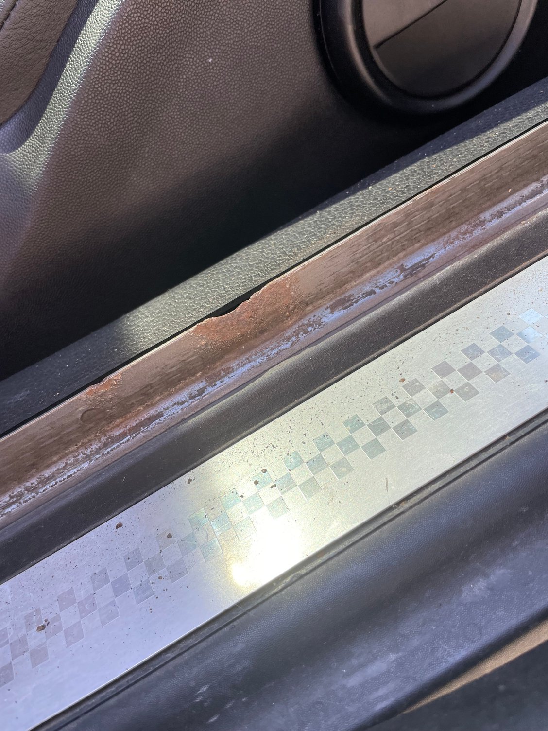

Rust: Check your weather strips!
R56 that spent its time in Texas and CA.
Reminder to check your door sills for rust beneath the weather strip.
common on both r53 and r56.

not sure I want to know... lol

Yep. I have 2 spots on each side. Plan to strip and epoxy prime this winter.

Yep talked about Gen 2 MINI rust here, found it first, well on my r58 lol
