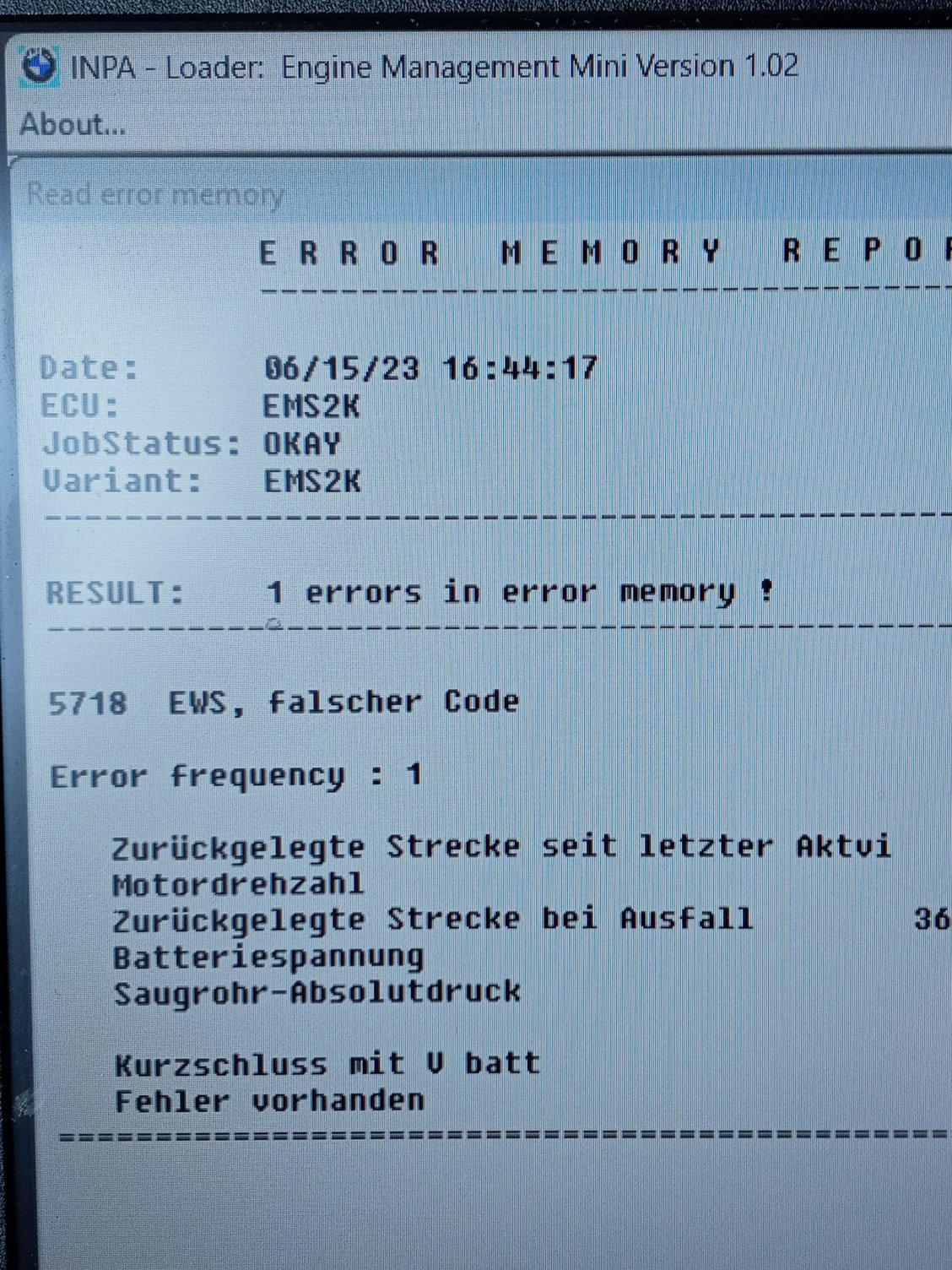

Anyone know what this relay is for? Its above the fuses in the driver's side kick plate. I saw it when i was removing my EWS to inspect it.

Got my car started.... first got 2 crank position sensors from rock auto still no fire..... Then bought a OEM crank position sensor and it fired right up!
also sent my ecu to ecupro and they said everything checked out fine DME, EWS and key. Might wanna check your ECU harness to see if its sitting square and flush....Hope you get your ride sorted out. Thanks for the updates.

I have a ignition switch coming in tomorrow, dont think it the issue cause the car will fire up when i spray starting fluid in the intake and die a few seconds later.
I dont think the injectors are squirting, with the car not unlocking a few times before this (cranking but not starting) issue Im really hoping its the EWS thing not telling the injectors to do their thing.
I hate to spend the money having the Key-DME-EWS sent out to ECU Pros and have it Still not start when i get it back.

I Heard back fron the ECU pros. they verified my (crank but no start) on their test car with my EWS DCM and Key.
And were able to fix it and get the test car running, So i should be able to toss it back in and start my car. Ill know in a few days.
If the terminal 15 error is the key tumbler,thats should be fixed also. I installed a new key tumbler .
I'll update in a few days when I get my stuff back andI get home, Im in NorthDakota for work right now.

UPDATE: I got my EWS-Key-DCM back from The ECU pros. Put everything in, First thing i noticed was the Key Chime noise was back. The car fired right up !
Big shout out to @shrevemini for hours he spent with me trying to resolve this issue, he spent a bunch of his free time when he didnt have to.
