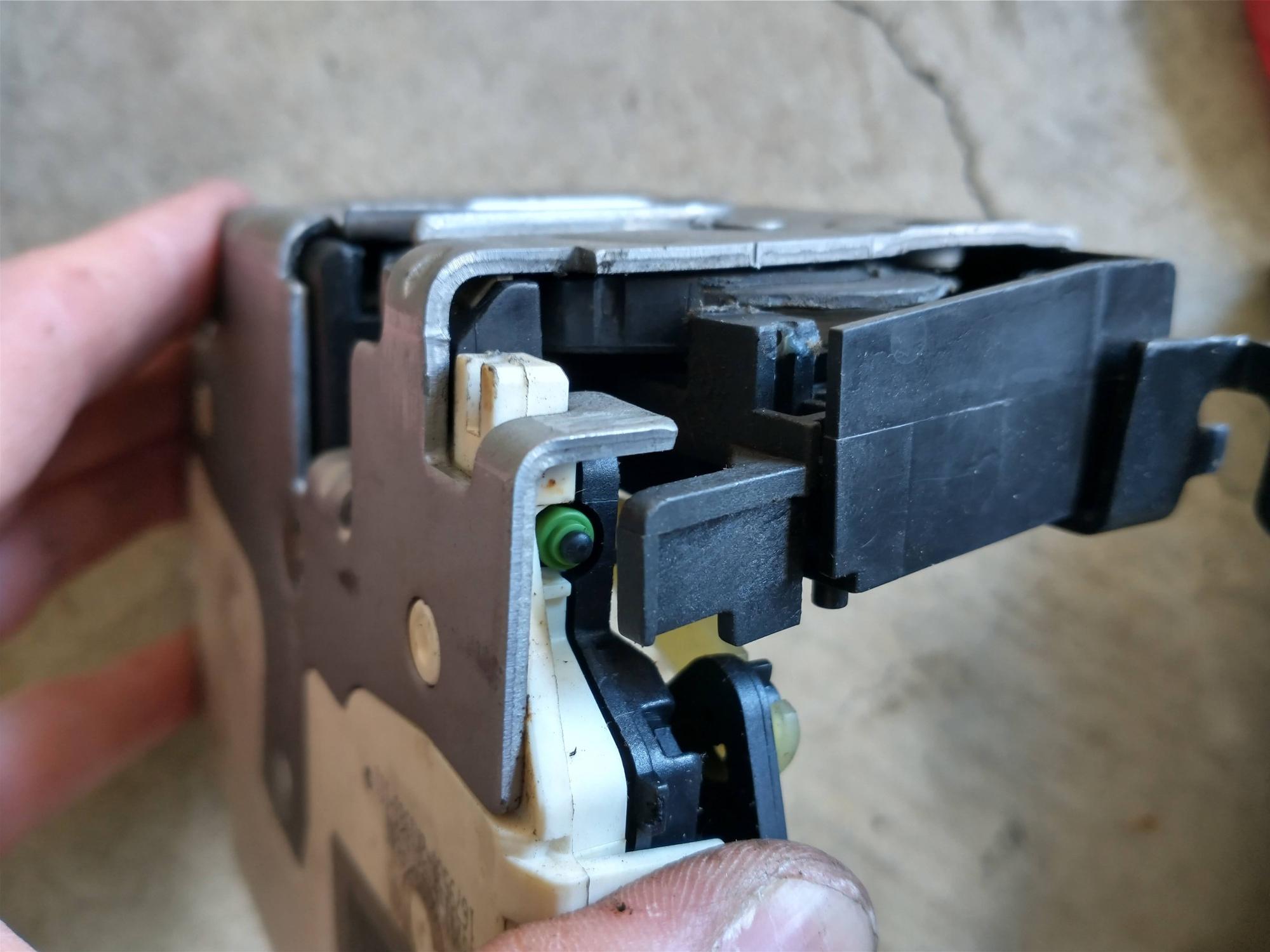

Finally had a chance to do some more troubleshooting on this today. Took the lock out and found the microswitch. It's the button with the green around it near the bottom of the lock. When the door is closed, the plastic lever pushes the button in, which opens the circuit. When you open the door, the switch moves up which actually closes the circuit alerting the BCM that the door is open.
First I checked continuity on pins 5 & 6 on the door lock for the microswitch in both positions. The readings were what they should be, the circuit was closed only with the button up. I even plugged this passenger door lock into the driver's side door wiring connector. Sure enough, it worked normally turning the dome light on when I manually moved the latch to open and closed positions.
Next, verified that pin 5 on the wiring harness was getting grounded. It is. So, the problem is definitely not with the door lock. There appears to be an issue with either the wire running to the BCM, or the BCM itself. So, that's the next thing I'll be checking..
