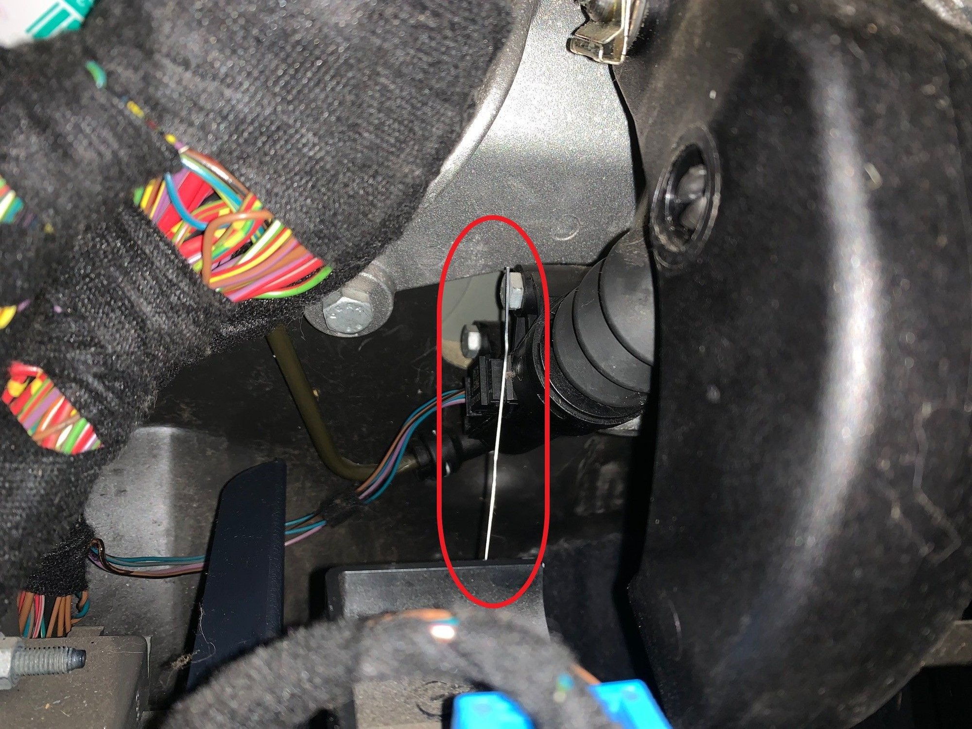

The picture below shows a paper clip hanging from the Master Cylinder from a magnetic force. When I depress the clutch pedal, the magnetic force does not move which indicates to me the magnet is hung up or broken free.
Can the magnet be repaired or does the Master Cylinder need to be replaced? Am I incorrect in my observations and presumptions, and do I need to check or replace another part?

Yes, your observations and presumptions are correct. But before throwing a new master cylinder in there check the power and ground to the switch.
Unplug the connector and with the ignition on you should get 12V on pin 3.
Pin 1 should have almost no resistance to ground.

Is 12V on the #3 and ground on #1 a mute point if the Coop starts with a magnet next to the Clutch Switch?
