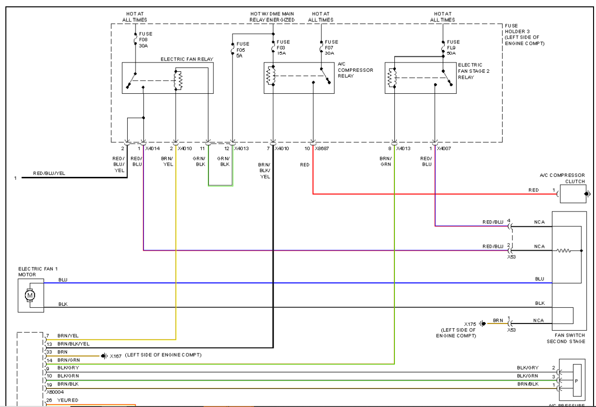

Hey all,
Having an issue with my auction R53. Everythings been great except for the summer heat. Recently had the AC recharged (by a shop not myself) but realized the compressor isn't engaging. Fuse is good, swapped relay so that's good. I went ahead and jumped the relay to give direct power to the compressor and it kicked on immediately. Any thoughts on what this could be?
Maybe vacuum pressure is dead? The cars had electrical issues so my thought is maybe a bad wire that way.

Bigger issue was clutch not automatically kicking on, only when I jumpered the relay. No successful updates yet. I replaced the pressure switch, still no go. Mini themselves evac'd and recharged the system for me, its holding pressure fine. They said they were getting weird voltage readings with diodes hooked up to the compressor. I refuse to believe its the compressor as it turns on every time I jump it.
Fuses 3, 5, 7 all have power at both sides. Checking Pin 13 (from X4010) it reads 13v no matter what. If I jump that wire, clutch engages and AC kicks on.

Found my issue. I replaced the BCM as mine was shot from water damage. Turns out the car I stole it from had standard ac, where as my car had automatic AC. Finally had a brainfart, and check the software, and low and behold I just had to enable the auto ac and disable the manual. Everything works great now.
