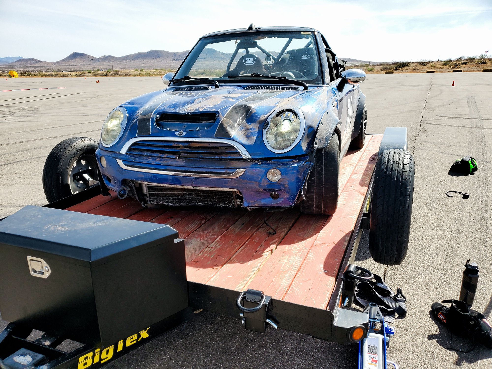

Background info: 05 R52 dedicated track car. Mostly stock engine wise, gutted interior, upgraded and refreshed suspension, etc.
Got a little overzealous and overcooked a turn, going through the gravel pit and into the tire wall. By the time the impact happened I wasn't going all that fast, so I thought it was mostly just going to be body damage.
