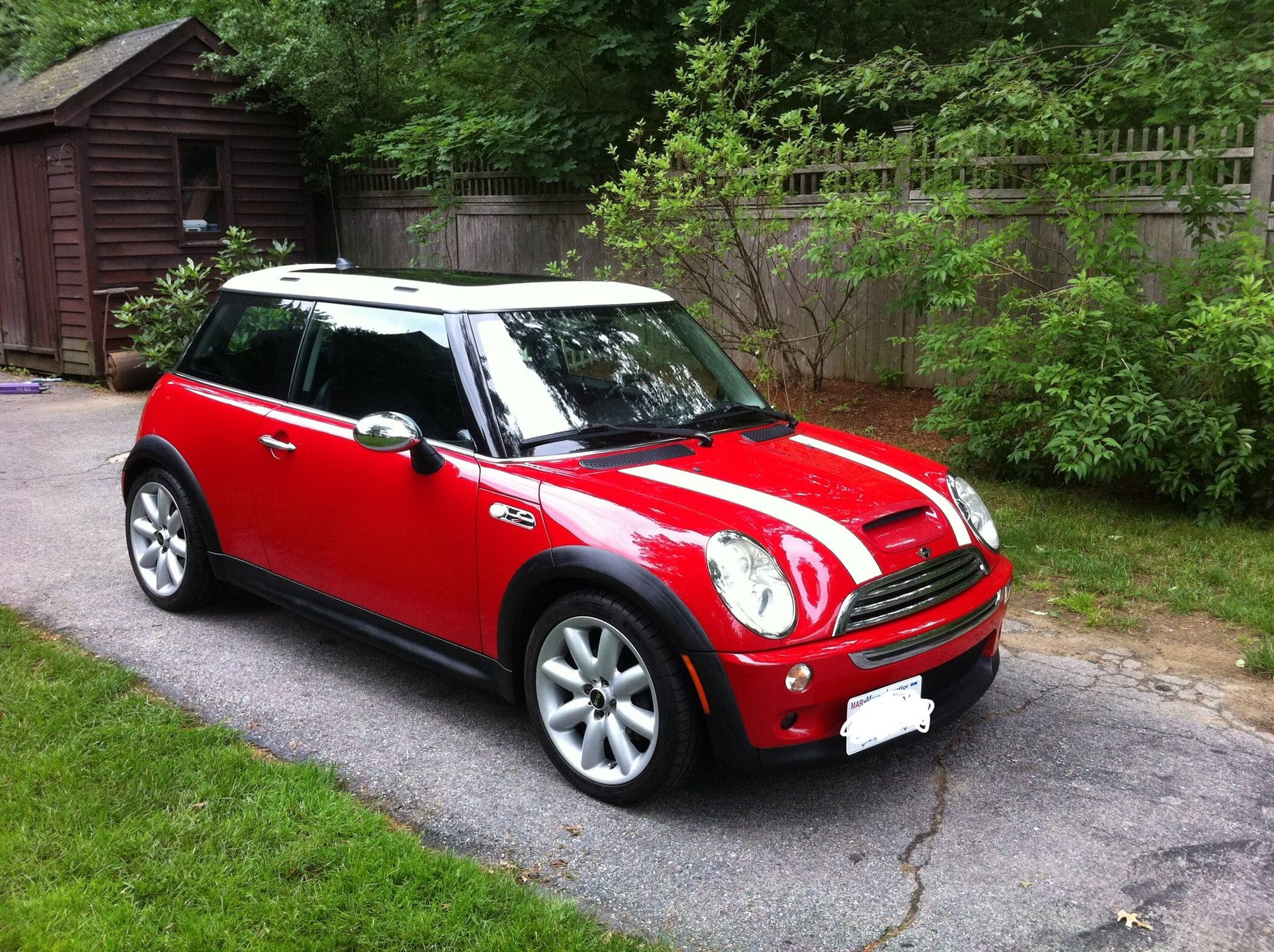

Here’s motivating picture to pull at your heartstrings
