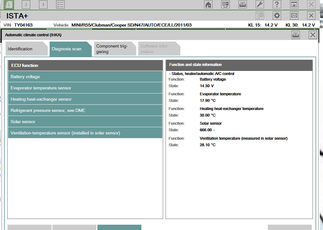

Hi guys
My mini is equipped with automatic control air condition. This is the situation on IHKA ECU scan by ISTA this morning all the sensor are working.Somehow I was able to switch-on airco compressor and evaporator sensor show me 5.7 degrees. After turn-off / turn-on the cairco compressor stop working again. No one fault code appear.
