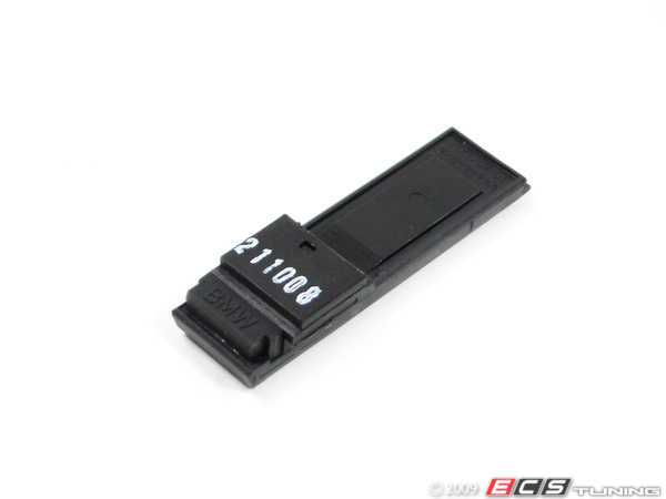

Ok, try to replace the clutch pedal switch, its shared on the gen 1 and gen 2 MINIs.
