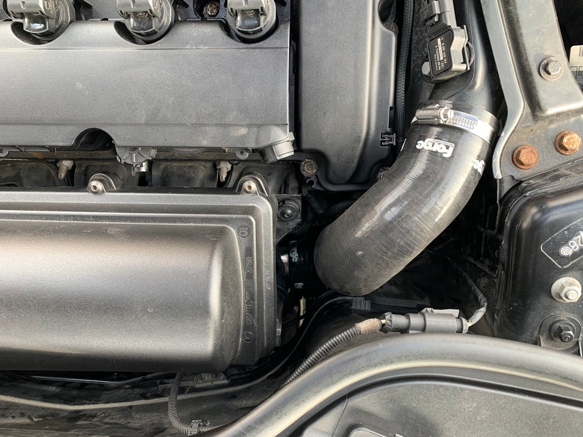

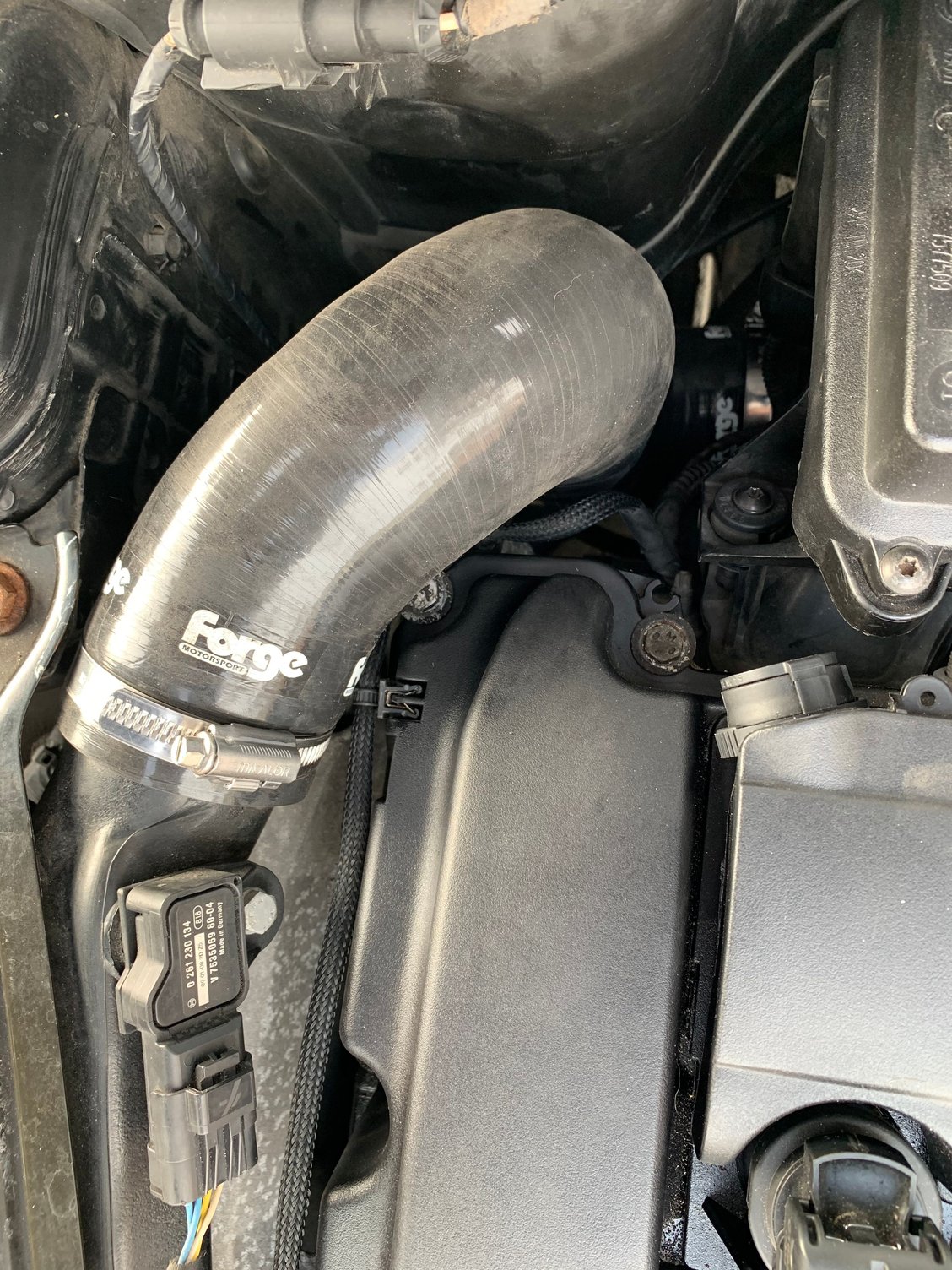

I have read about plugging it, I deleted it and installed a forge noise maker delete. Car runs like a champ. You might actually have a leak from the plug.
This isn’t going back in

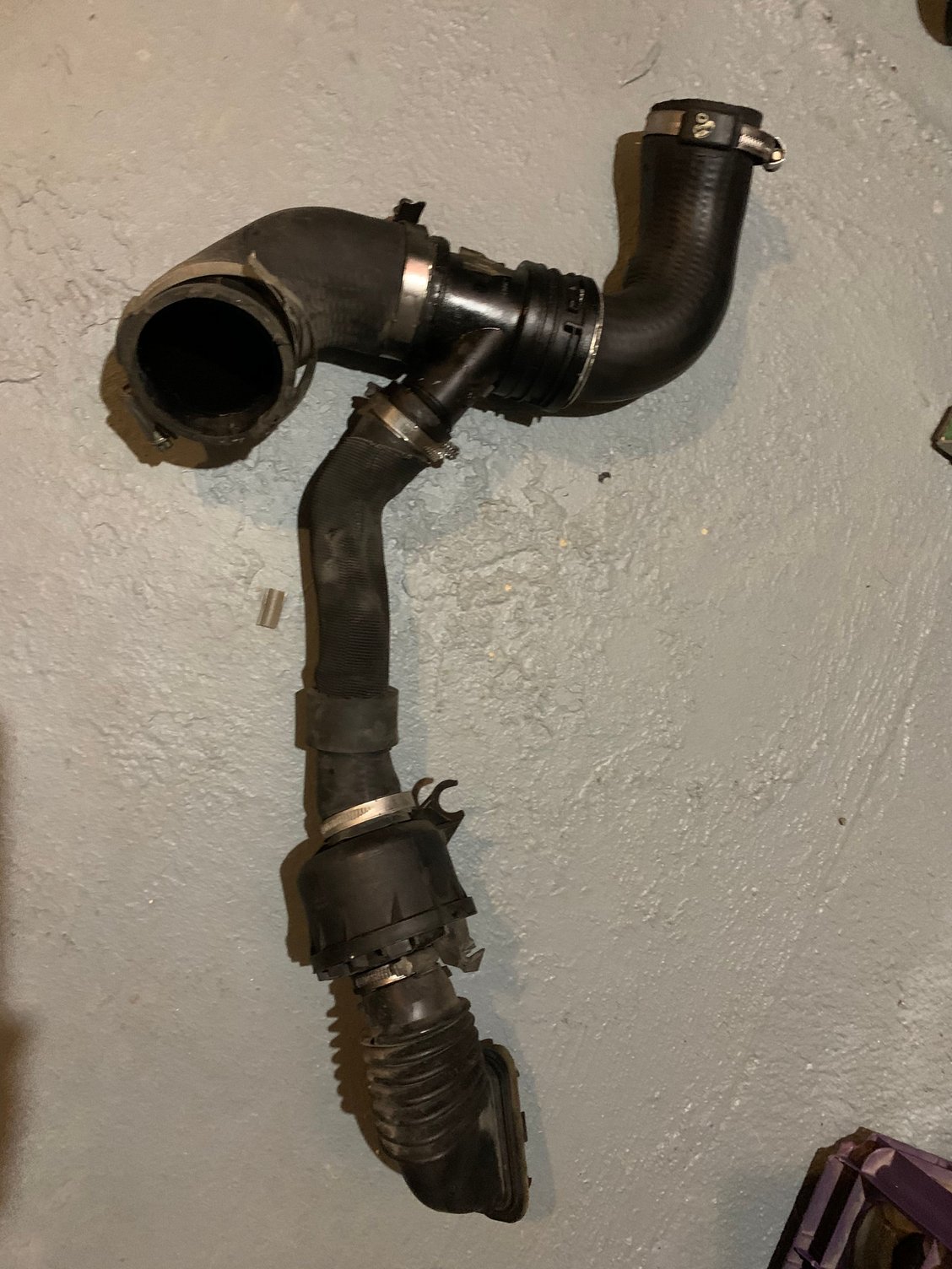

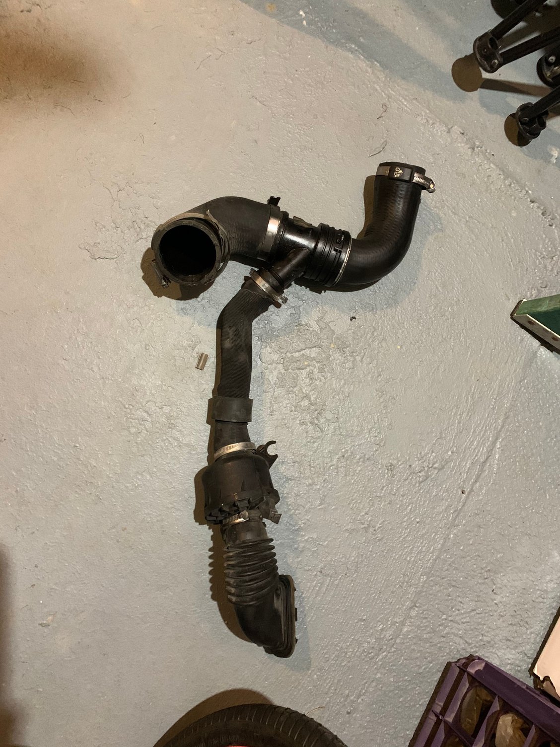

All of those stock piece are boxed up collecting dust in basement, no intentions of it ever going back in.

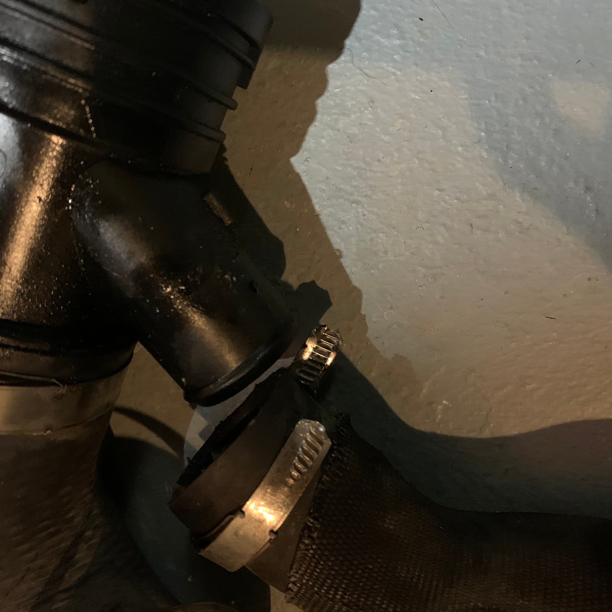

This is the one b band I had to cut, it’s a small one.
