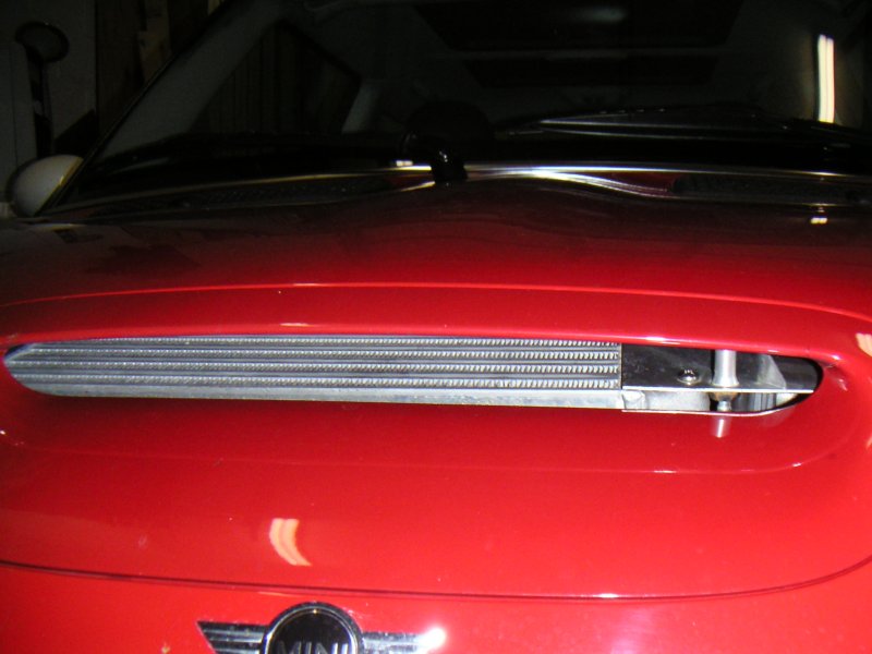

One interesting experience I had with comparing the Alta and the stock intercooler was this. Both my car, with mods including the Alta IC, and a JCW with the factory IC. We both dynoed the same day and on the same dyno. We each got our max HP numbers at the crank. Now here is the interesting thing "I" think. we both also got a shot of Co2 into our hood scoops. The gains were quite noticeable, but my gain was about 30% more then the JCW.
My Alta IC does NOT block my hood scoop. Yea, it maybe up about 1/16", but it seems to site very nice. The surface area of the Alta is huge over stock, so I have to agree with what I saw that the Alta is more efficient.

Thanks for posting that pic. It does not look like it blocks much of the scoop opening at all.
The CO2 experience makes sense. Not only is the Alta's surface area bigger but its mass is larger as well. So, by chilling each intercooler (with a fire extinguisher?) the larger one acts as a larger heatsink and should give cooler outlet temps for your run immediately following the chilling.

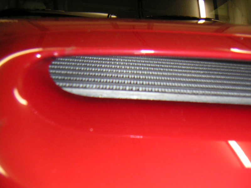

Originally Posted by supercoopers
Alta Peformance,
Please find attached a pic of my hood scoop with the larger top mount intercooler fitted. As you can see, approximately 40% of the scoop is blocked. My car was made in November 2002 and the intercooler was bought from Minispeed in the UK. As it stands, the current configuration offers virtually no benefits over stock. What do you propose I do?
Please advise,
Henry
Holly crap That ain't right! Mine is the first generation Alta TMIC and mounts pretty flush to the intake. It hovers about 1/8" over the mounts and occasionally touches it.
Hence why I am SOOO annoyed that I have wasted my money on this product and my vendor (minispeed) reckon it's ok! The intercooler was profesionally installed btw.
I am really disappointed
Henry

Supercoopers,
That is not normal at all! Can you tell me if you have aftermarket motor mounts? Also does your IC sit on the post on the manifold? Last question, is the opening of the scoop bigger than the stock one? I am asking because i have seen another scoop made overseas that was bigger and didn't fit real well to the car.
ONASLED is right about the other things to look out for. The wire harness under the manifold, the hoses, the brackets being gone, ect.......
I know you are far away but a phone call or emails direct to us can get you taken care of pretty fast.
MSFITOY,
The older cores should sit about .125" off the post, and clear the scoop like it is. The newer core sits on the posts and is slightly thicker by about .125" making the IC sit flush with the scoop.
Supercooper,
About the rows, they have nothing to do with performance. Just because this core you are talking about has 16 rows doesn't mean it is way bigger! We could make our core with 20 rows if we want, but it doesn't matter. You still end up having roughly 50% charge air flow vs. 50% ambient flow. In fact the smaller rows actually can hinder performance! The overall size is what matters.
With in reason, you can't make the IC any bigger! Look at how it is made and where it is. To say our IC is not "massive", is INCORRECT! To help you and other NAM member visualize this is the data comparing our IC to the stock one. This isn't something we normally publish because of competitors seeing our exact specifications, and reasons why this IC better than stock. However, in this discussion we feel it is important to publish this information to help clear up some misconceptions.

The first few people that complained about this issue, stumped us. But most every single issue lately had been from the motor mounts. It seems to be from the way the SC pulley is installed. People Jack up the motor, remove the mounts, install the pulley, install the mounts and tighten before letting the engine at a complete rest. This causes the motor to twist front to back a little, in turn raising the IC up in the front.
The fix is somewhat simple in that you need to loosen the mounts, pull the engine forward (twisting the engine) and retighten. This has fixed nearly all people that have had this problem.
Give it a try and let us know how it turns out. If you have time give us a call and we can point out the mounts you need to loosen.
