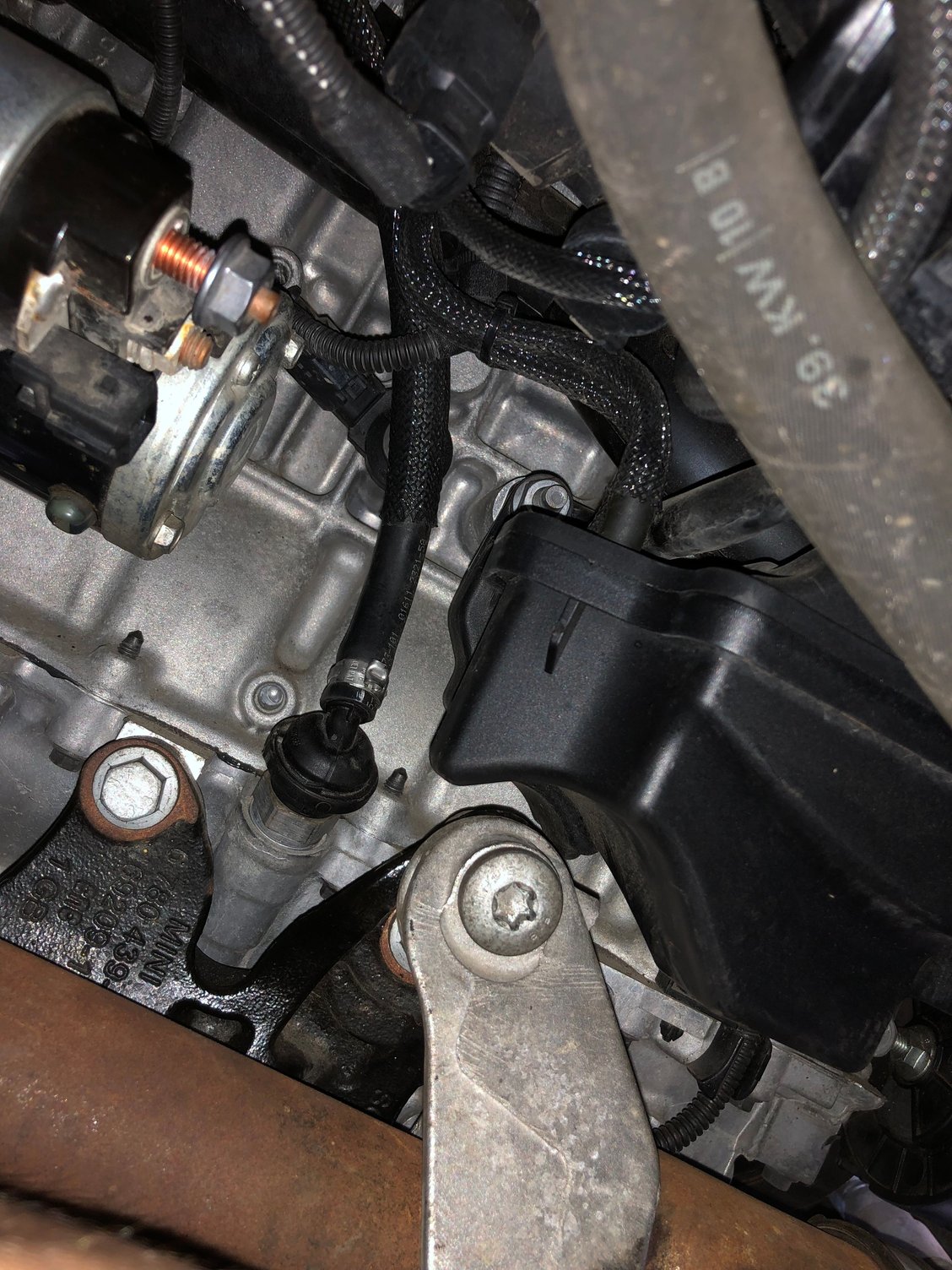

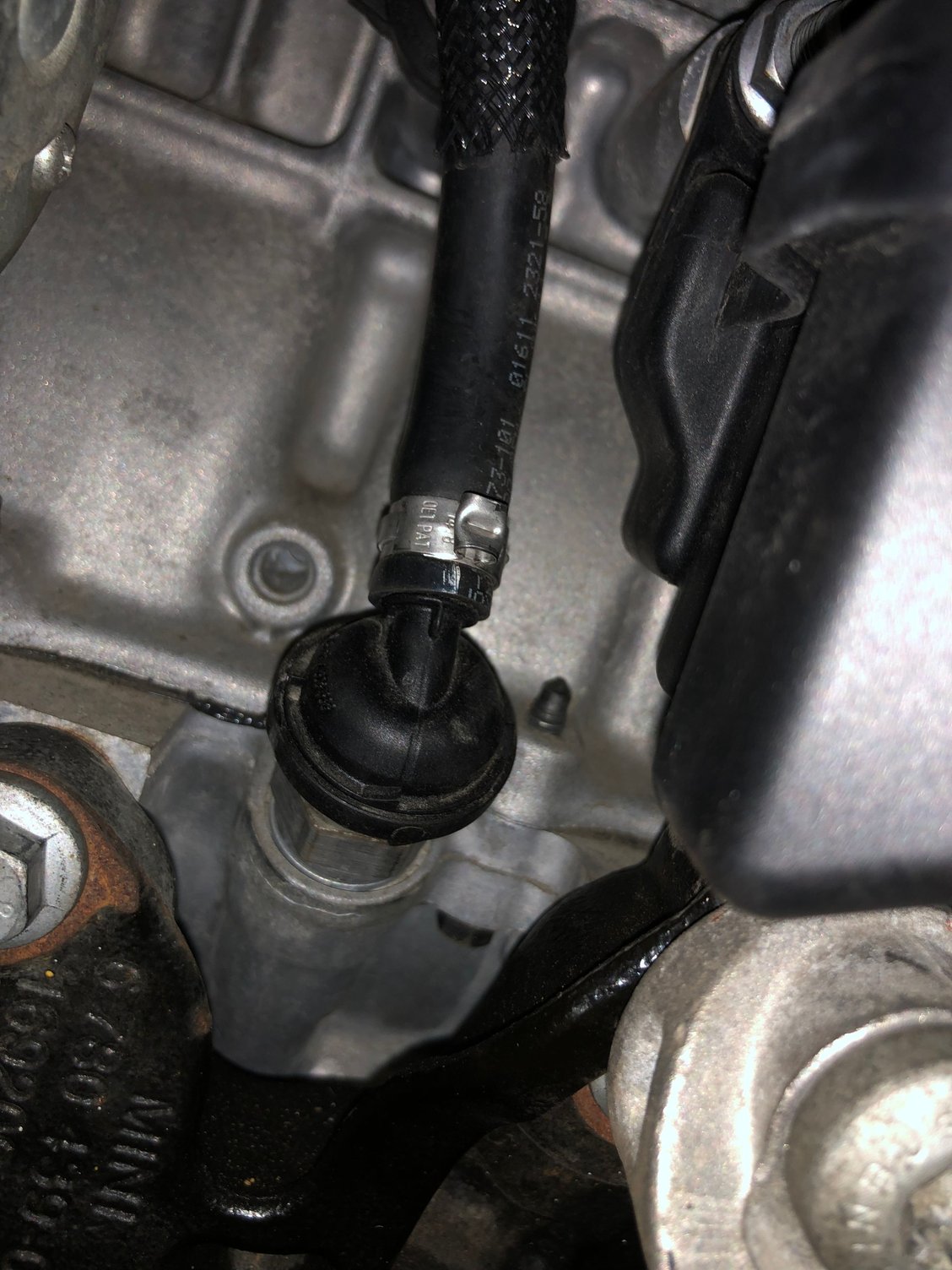

I’m am putting in a new motor and I found a rubber line that goes into the block behind the starter and my old engine doesn’t have it I don’t know what it does or what it plugs into

it is a ventilation line that goes to the intake pipe going to the turbo. if your engine does not have it, you can just remove this hose and transfer the plug to close it.
