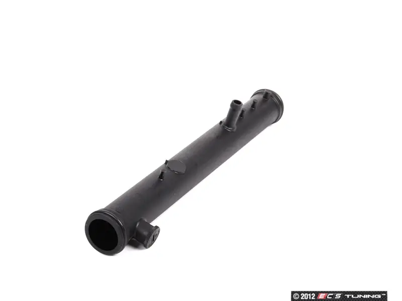

So recently replaced the crossover tube 3times. 1st one being eBay 2nd 1 being a aftermarket from a parts store.3rd is oem bmw/mini. Take a look at the different heights. Left is ebay ..middle is parts store...right is oem.
ebay and parts store brand both leaked only when the car was cold. It did not leak when hot or running. Finally the oem one fixed all problems.bottom pic the oem is on top.moral of the story cheap ones leak.

I found the difference to be the O-Ring. If you look at the OEM O-ring, you see it is smaller and loose compared to the much thicker one on the left. The reason the OEM does this is to allow the O-ring to be pushed in and then "flatten" into the space left in the crevice, filling it and thus holding the part in tight and leak free. It really is as simple as that. I believe you can make the cheaper ones work but you still need to buy the OEM O-ring and throw the cheap O-Ring away. You would think the thicker O-ring is more likely to be tighter. However, it won't fit in the space. If you are able to cram it somewhat, chances are high the O-ring is not completely in or had to become deformed to get in.
However, this was a nightmare lesson learned because I didn't buy my parts from E-Bay, I bought them from ECSTuning. I called them first and they told me the one I was buying that was cheaper was the original equipment provider. I know they advertise on here and a sponsor, but I have had nothing but problems with them. I will never buy another car part from them so long as I live. Generally, at this point, I just buy the OEM parts. They cost more but it will save you hours and hours of headaches trying to make the wrong part work, dealing with products that never get shipped or never received and the hassle of being lied to. Nothing beats ZEN, easy installation and something just WORKING right from the start.

The original might work and im not saying all aftermarket tubes are bad. There may be some that are good. The 2 aftermarket ones i tried would sit crooked in the water pump opening bc the angle curve was off. They both leaked only when the car was cold then i installed the oem pipe which also felt loose but not a drop. The reason they leaked was bc the pipe wasnt sitting flush but a couple of degrees off bc the angle of the curve of the pipe was off. Reason i wrote this is i dont want someone wasting time trying to make bad parts work. The aftermarket pipe is 25 vs $90 for oem. Not worth the time and headache just go oem. However i did use numerous aftermarket thermostats b4 with no issues just fyi

For our MINI people on the forums we have some early release Aluminum Metal Water Pipes. Not too many in stock so they might go fast. We will have more coming in soon after that.
I have been running this on my personal car for almost over a year. Matches the factory design.

I am convinced the original pipe isn't THAT bad. My engine has 170k+ miles, and I replaced the thermostat but left the OEM pipe.

When we removed my Genuine MINI one with about 100K is fell apart on the end connected to the back of the water pump. Much like most of the pics you have seen.
So the Genuine MINI one might last long, but if you touch anything around it to do a repair, it cracks and leaks. The thermostat touches it and anything from carbon blasting to waterpump work you might bump it.

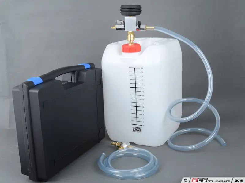

While on the subject, on a scale of 1 to 10 (1 being easy as changing the oil, to 10 being hard like replacing the suspension trust and shocks on all sides) how hard is it to do an coolant flush?
I need to do ours and on a video made by a Mini mechanics he uses some vacuum system to check for leaks and remove all air:
It's sounds complicated?

I have the Schwaben coolant vacuum tool, and it made changing my thermostat almost easier than changing the oil. The hardest part was getting the clip that holds the tube on the thermostat back on. That task alone took me almost 30 minutes.

Yep its here: https://www.ecstuning.com/b-schwaben.../024948sch01a/
Factory tool is here: https://www.ecstuning.com/b-genuine-...392152473~oem/

So in all cases this requires an air compressor?

The tool does require a compressor. It uses the air flow to create the vacuum.
If I was only changing the coolant, and not performing the full thermostat replacement, the vacuum tool makes it way easier than changing the oil.

Ah, that's what I thought... And I don't have the garage space to own a compressor currently...

Even something like this would be plenty to run that vacuum tool:
