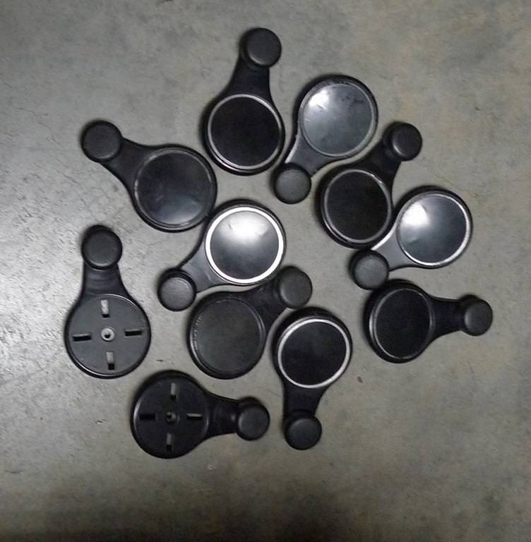

For instance,
I always converted my mid 80's Saabs from electric to manual windows LOL
I still have a good clutch of window winders!
I'm with you on the red turn signals --- not good and I wonder how they became so prevalent over here.
I got myself some Euro MINI amber brake lights but I need to joey mod them before install.
I much prefer amber turn signals.
