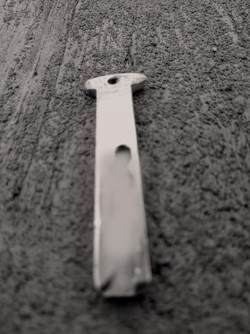

This post puts it in my mind how important it is to have a safety-net spare key, for me it'd be in case of accidentally leaving my keys in the car and getting locked out, but for others with frequent passengers it'd be a good idea for them to have a spare as well which would enable them to insert into ignition and unlock the car as was the topic in the original post.
A valet key would be ideal and slim enough to fit into a wallet, but apparently they're NLA from the dealer:
https://parts.miniofkennesaw.com/pro...317072782.html
I bought my car used and it didn't come with the valet key, but the previous owner recently had a brand new key made after the original bit the dust and couldn't be used remotely,
which he also gave to me.
In light of this thread I dug it out and disassembled it down to the bare bone which allows it to fit easily in my wallet and provides a safeguard for me.

Metal key blanks are readily available on eBay - where you get them cut/engraved/routed is a different matter.
I assume the key will operate the door lock,& the ignition switch & re-enable the doors etc, but it won't start the car because there's no immobilization 'slug' - correct?
Correct, it will not start the car.
Yep on eBay,
for as low as $2.50 you can get a blank...
...but I've read that the cutting is quite pricey,
dealer only I assume?
