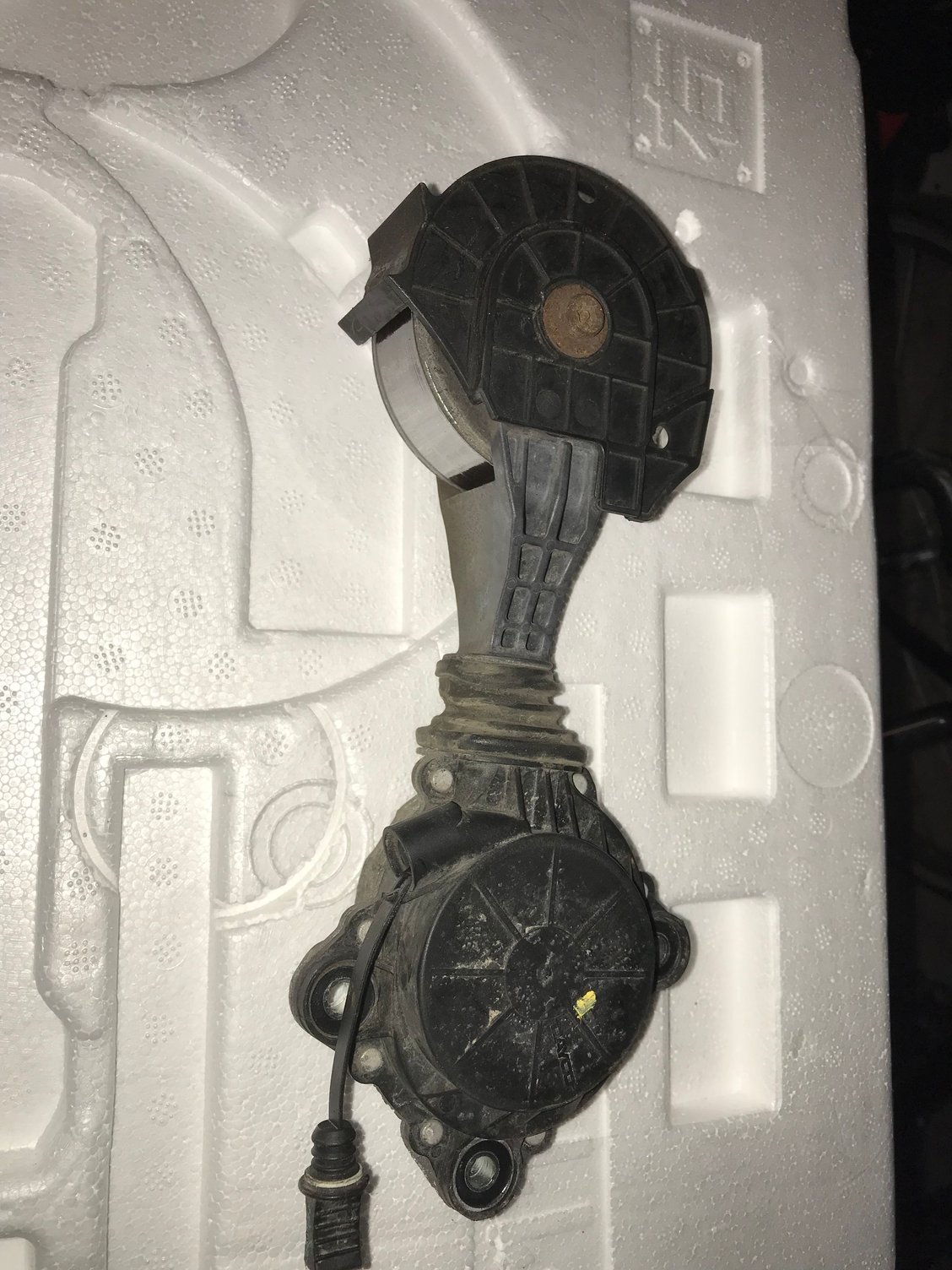

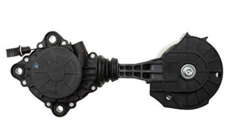

I found what seems to be the perfect solution on amazon! The dealer want about $150us +tax for the whole assembly yet just the wheel is being offered at $15.... this is a great idea. The only concern I have is what is the quality of this wheel and bearing ? Any one try this?
This wheel is inside this $150 assembly :

I'd buy that whole part due to concerns of the bearing quality. If it seized could make a mess of things.

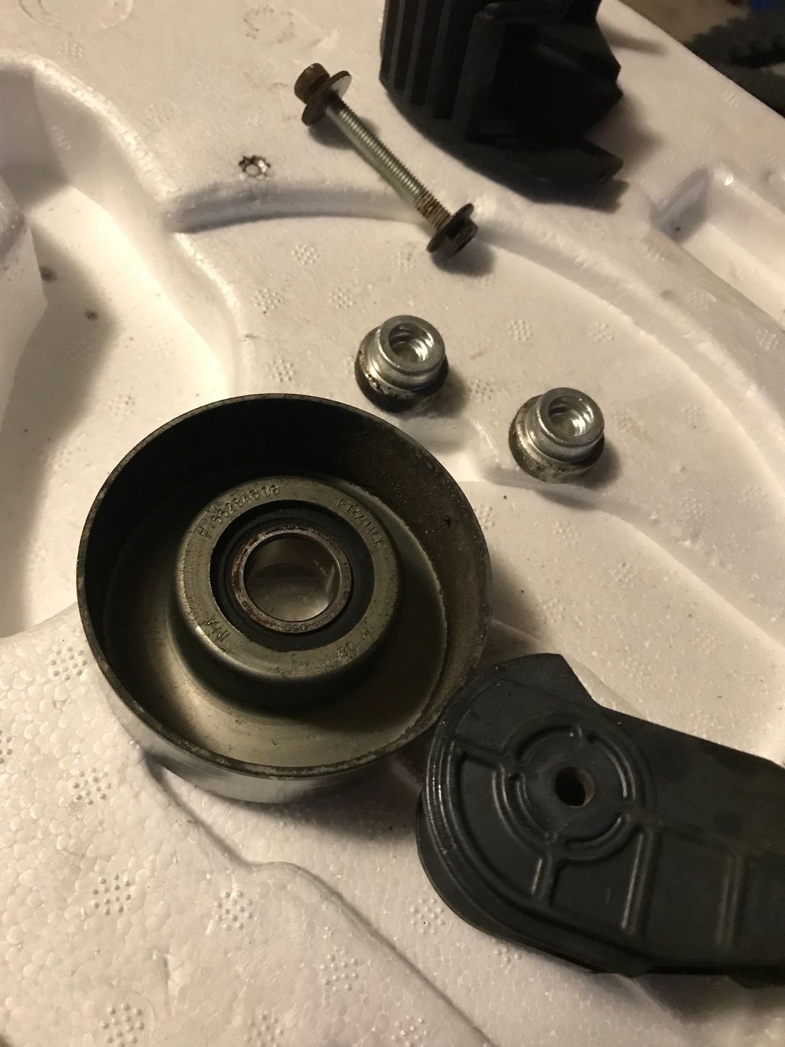

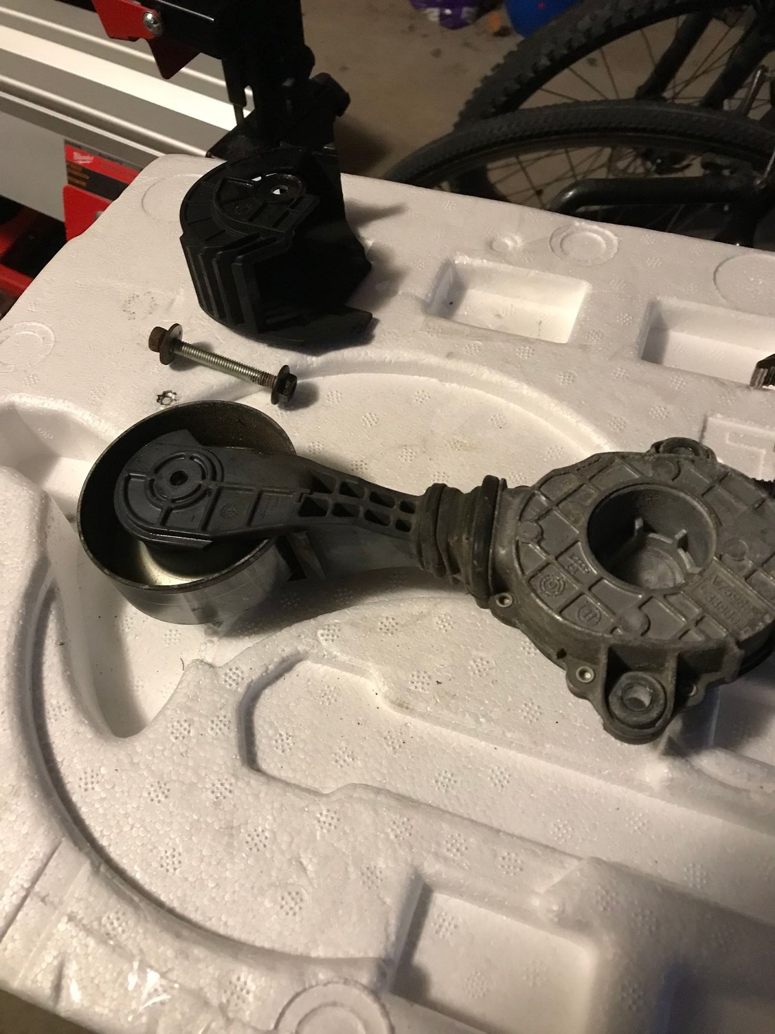

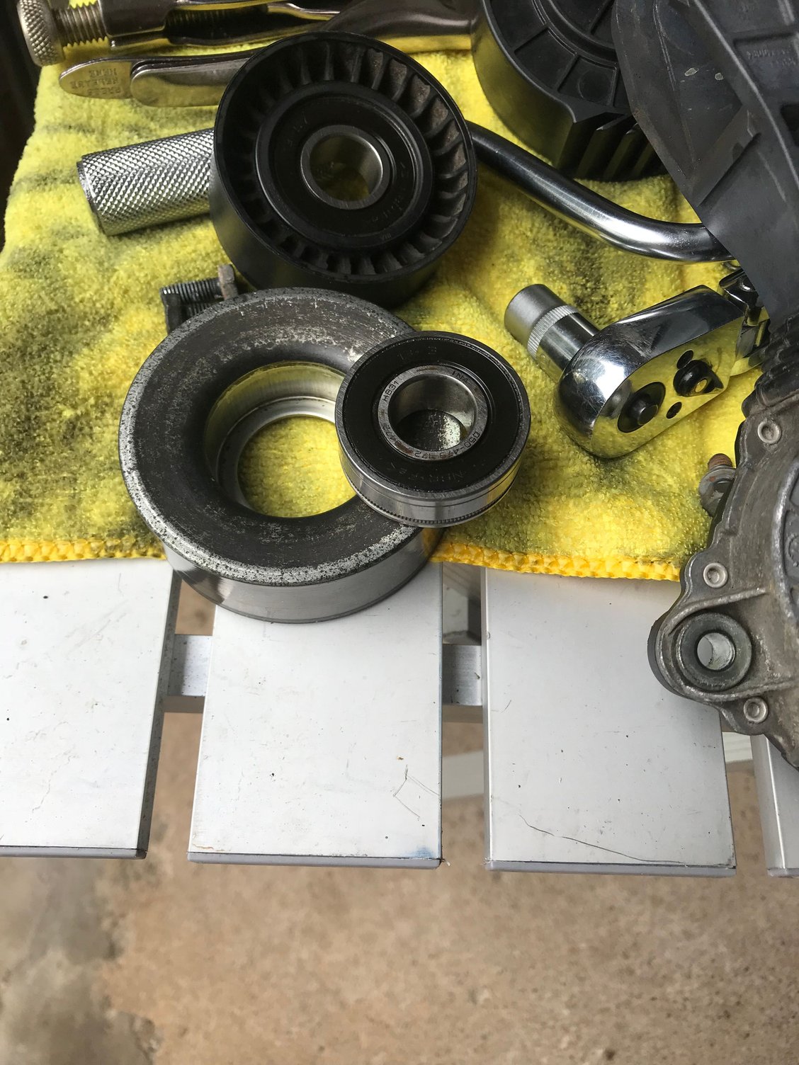

Well forget replacing the bearing as the friction wheel has some unusual wear on it - I’ll likely replace the whole friction wheel unit.
It was a major pain removing the friction wheel but I’m glad I did it. I followed the pelican parts process and dropped the one side of the engine however that didn’t give me enough clearance. I managed to get the theee 10mm bolts out. What a pain. Not sure yet how I will get them back in but I’ll deal with it when I need to.

So upon inspecting the friction wheel once disassembled, I spun the bearing and I didn’t hear any loud noises or clicking. There was a very little play but my experice with precision bearings is there should be zero lateral play. Either way I’ve take the decision to replace the friction wheel assenl

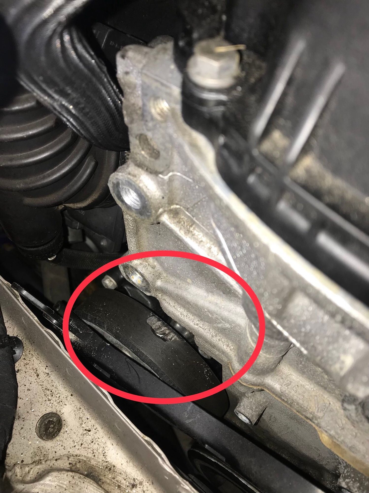

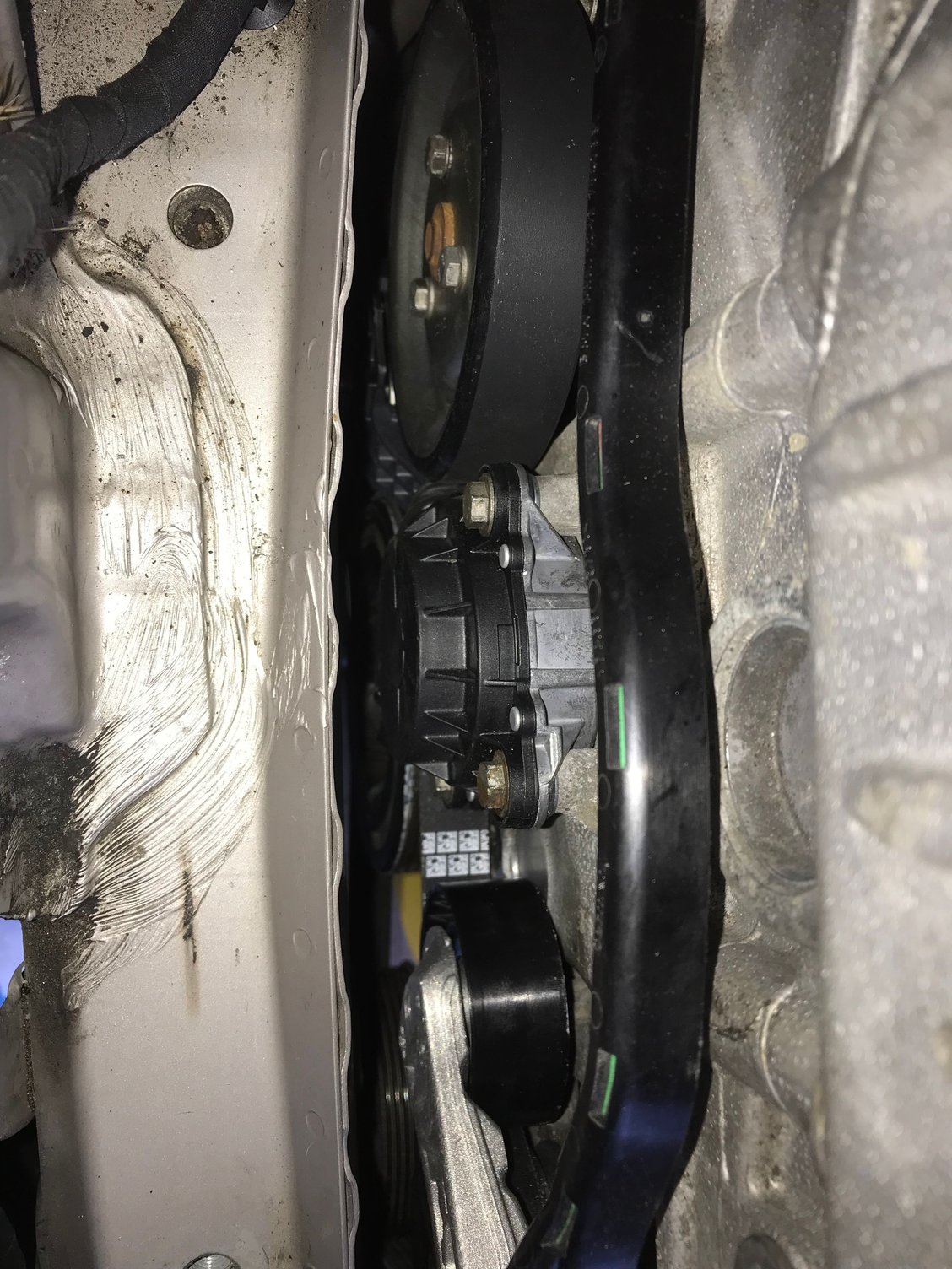

Now that the friction wheel assembly was off, I took the time to inspect the water pump pulley more closely.
It seemwd ok previously however I started rotating it to see the complete surface and I found a chunk missing.
These minis are inherent lemons.
Now I have to replace the water pump pulley as well.
Thw investigation continues.....

Another picture of the missing chunk from the water pump pulley - no doubt contributing to the strange sounds.

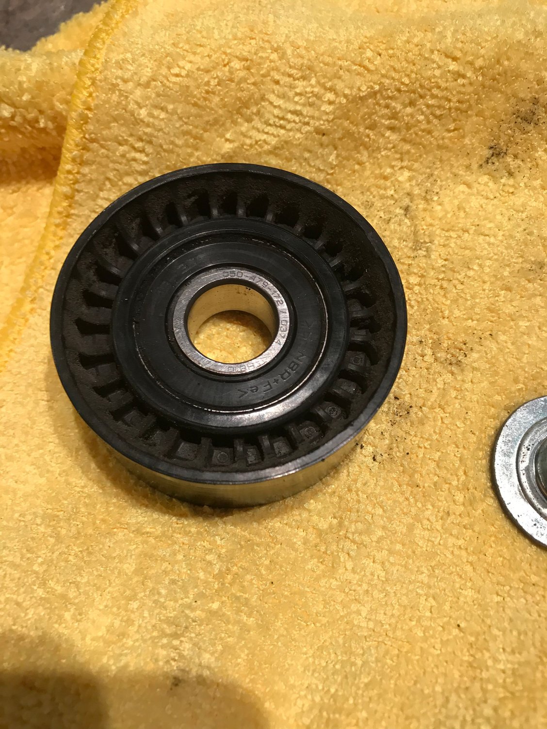

I also managed to take the tensioner pulley off.
There was a lot of oily/greasy residue on it - I suspect seeping out from the bearing. That said it seemed in good shape. No lateral play, no sound - I connected it to my cordless drill and spun it up ;-). I
Tensioner pulley. I put penatrating oil on the treads, let it sit over night and it came off with a little force.
