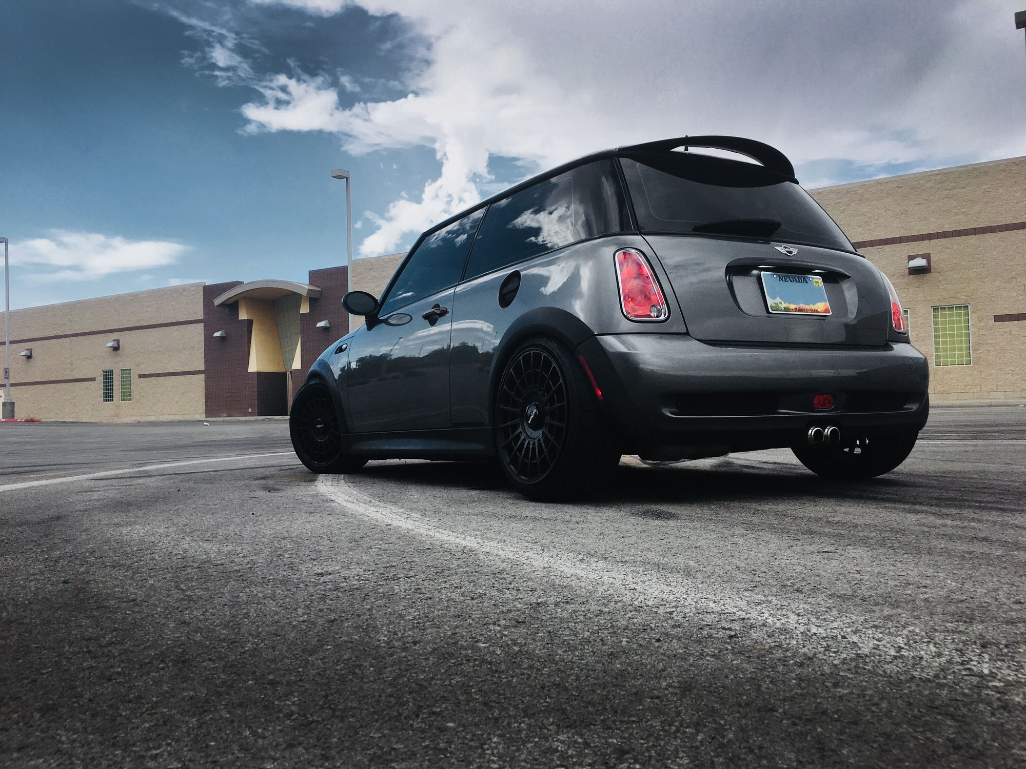

It could be the car is lowered too much for the range of the CV joints, or the axles just went bad again. There have been several posts of inexpensive axles not lasting on MINI’s, even on non-lowered ones. Setting the CO’s very low could have been too much for the O’Reilly’s axles to handle. Any pics of how low the car is?

You could be right about it being too low. They're nearly bottomed out, but the tire is not tucking or anything. I may raise the car slightly and see if the problem abates. Or do you suppose the axles may already be bad?
Here are some photos for reference. Low but not completely slammed IMO:

Not sure if you’ll be able to get it back to stock height as Megan’s usually have a minimum lowering height of around a half an inch, but that small of a drop shouldn’t have vibration problems with the CV’s if they’re ok.
