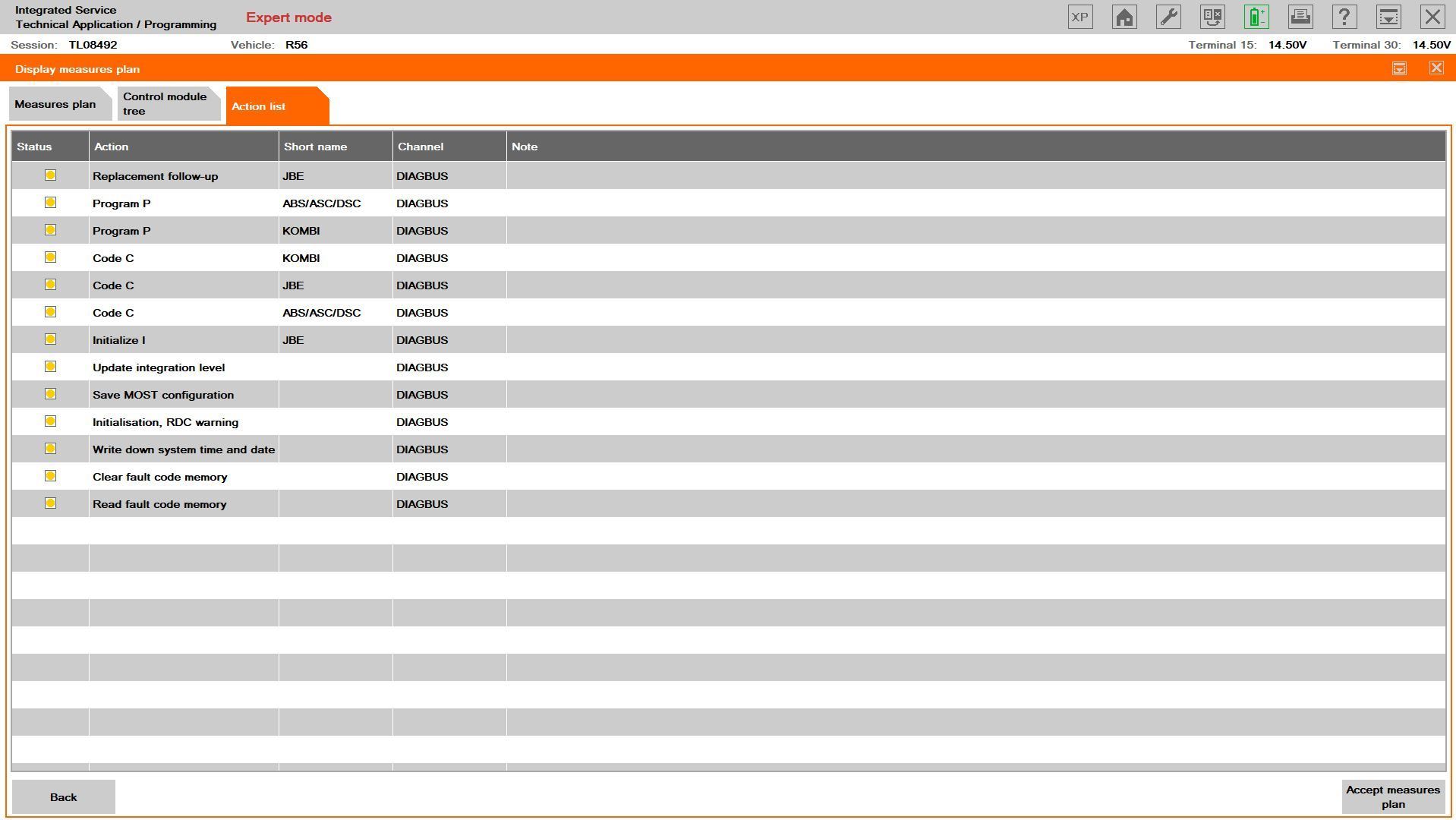

Great....now you can right click on the modules you do not want to program. An action list will come up. Click on the second tap where it shows the action list like program, code, replace, amd initiate. At the botom, there is "hide action or process", click that. Now the module will be removed from the action list.
Post pictures when you get to that point to confirm.

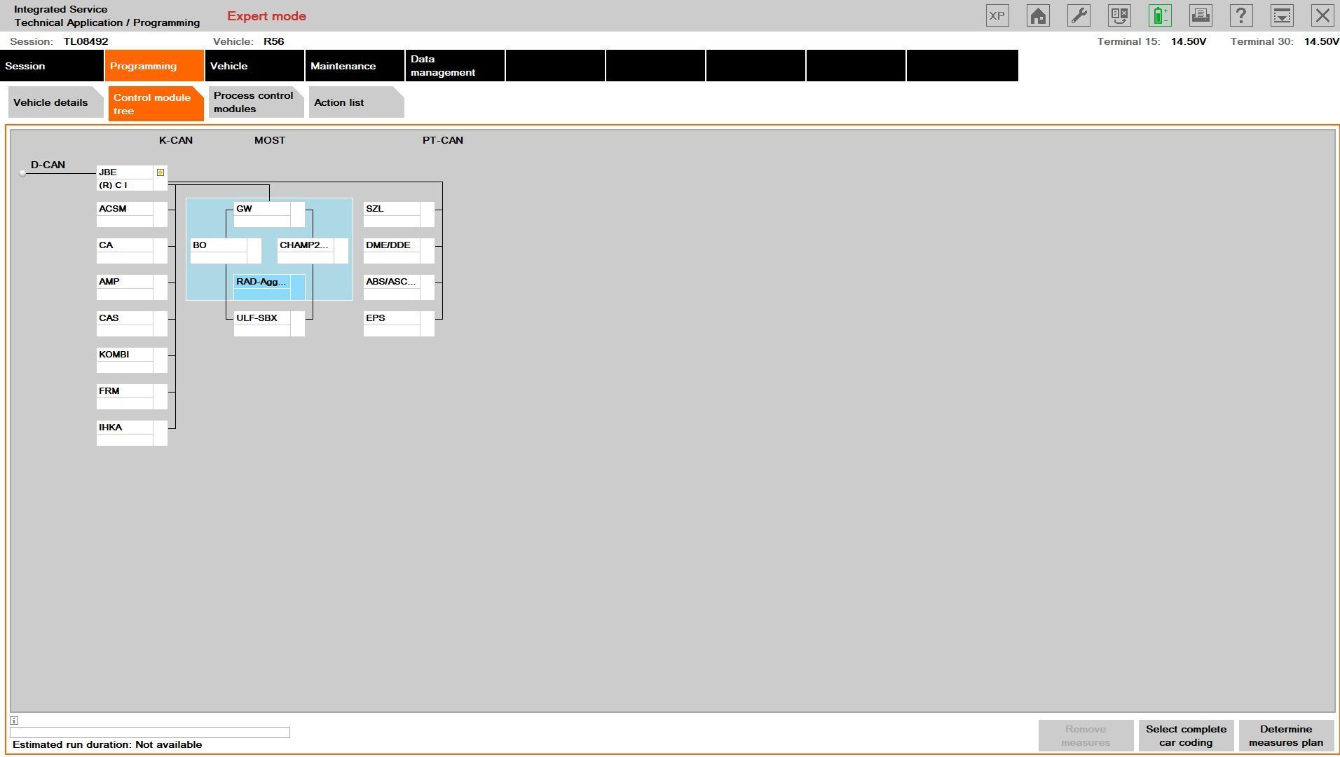

I have stupidly selected one of the immediate action list and the MOST adapter is gone. It is the EMOA in the immediate action list. Is there anyway to get the MOST adapter back ???
This image clearly show that MOST is not there and i have not proceed with the programming
Question : I can't just program and code the JBE, whenever i select "Determine measure plan" it will include KOMBI and ABS/ASC/DSC.

As for the MOST ring, i can still see it. If you mean it shows it in blue that meant it was gone, that's incorrect. As a rule of thumb, being able to see the module means it is there.
When it comes to prog and coding, istap usually adds few modules to the mix for some reason. That shouldn't be a problem. If this is the minimum requirement to run the process, so be it.
Again, if you dont have winkfp and ncs, maybe you should get them. They use the same cable anyway!
Lastly, MAKE SURE your cable properties (thru device manager) are set right, specifically the latency time should be set to 1ms not 16ms.

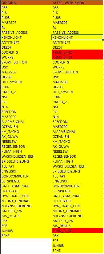

I have tried with NCS to delete the EMOA from the VO list, unfortunately unsuccessful, not sure why? Tried couple of time but the option still there.
Any suggestion. Thanks.
Update:
Managed to get rid of the EMOA from my VO list. My bad missing the delete key press after highlighting the VO entry. Now working on the coding the new JBE.
My VO list after remove of the EMOA - R56_#0309&T9E1%0851*MF92$210$226$249$255$2PA$313$3 14$322$329$345$346$383$420$423$428$431$441$450$481 $493$4AA$4AU$4BA$4BD$4UF$520$521$522$534$548$550$5 63$5AA$5DD$5DT$6FC$6FD$6ND$785$818$825$845$853$861 $864$872$876$880$8S2$8TG$925-A070-EWS4-SDON
