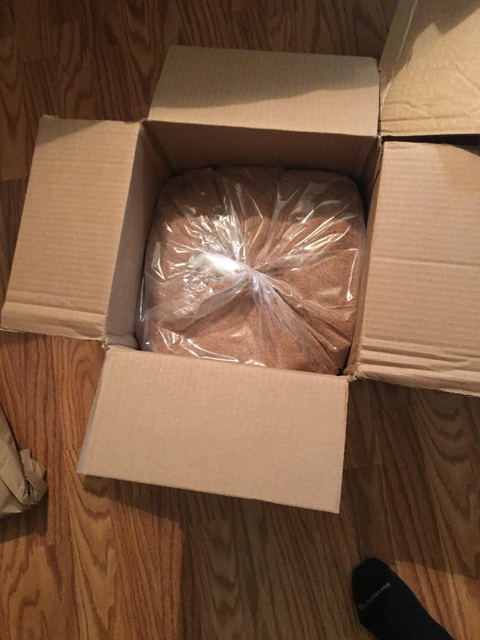

So few weeks ago
I was bumming around on the internet
And I ran across the guy
https://www.bavauto.com/bmw-media-blaster-b1100008
Ended up getting one
Have not use it yet
Next week project
Pretty good price 275 shipped
Comes with the n14 / n18 intake adapter
25 pounds of crushed walnuts
Basically everything you need to Walnut blast them dirty valves
You still need an air compressor and a Shop-Vac and basic hand tools
