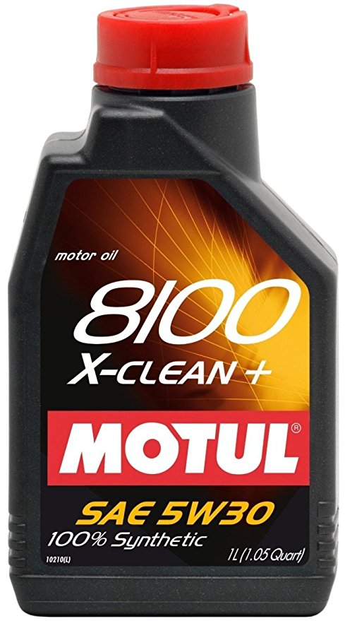

Motul 5w-30 is what I run and NEVER take my car to the dealership for a oil change. They charge too much.
Amazon Amazon
Attached Thumbnails New oil for R56 generations-2a051145-c50f-4f9a-bcfd-b4ea93d69bce.jpeg
