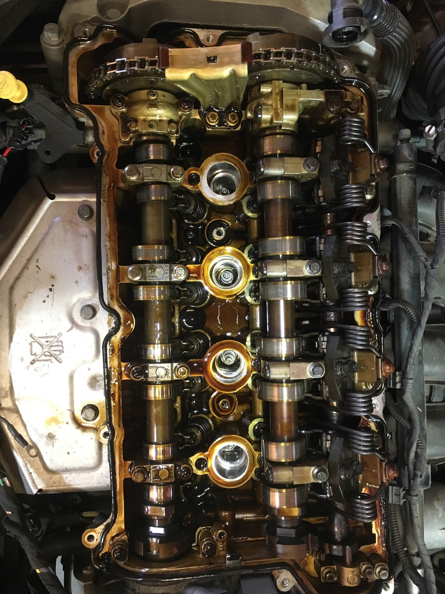

Finally got a chance to remove the valve cover. See pics. I don’t see anything that stands out. Is there a way to check PCV valve and timing chain to see if it is one or the other or both? The timing chain appears tight but I’m not sure exactly what to look for.

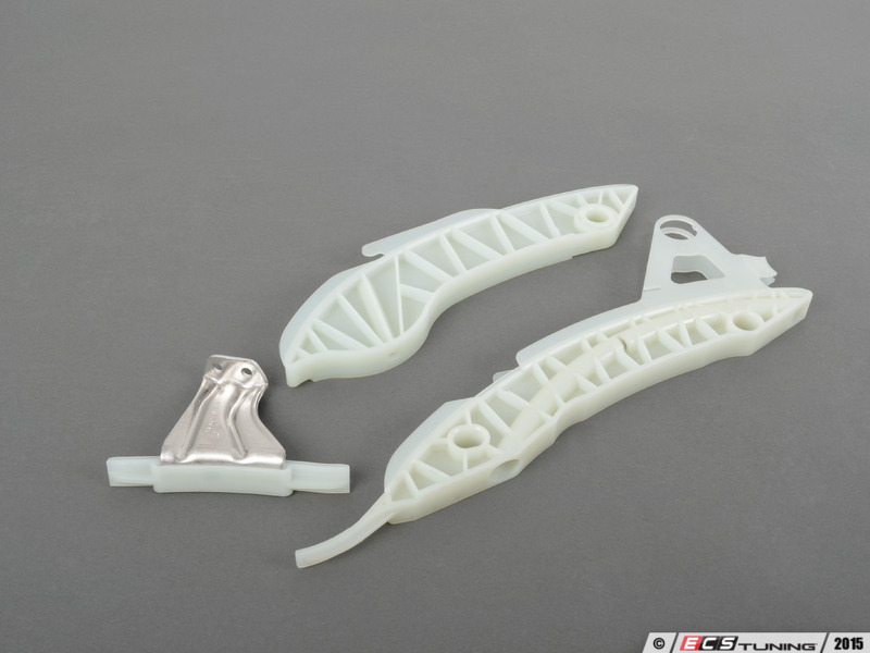

I'm pretty sure your upper chain guide should look like the one in this picture (credit ECS Tuning). Take a close look at yours, I think you're missing some pieces of plastic. My top guide broke on my '09 turbo (making the same noise) and I removed the oil pan to make sure there wasn't anything broken off of the other chain guides. I removed a piece of the top guide that was jammed in the oil pump pickup, then I installed only a new top guide and a new updated tensioner, and everything has been fine since...however, the best fix would be a whole new chain, guides, tensioner, sprocket, cam sprocket bolts, etc.
Your picture shows the updated version. The OP's pictures indicate the engine has the OE top guide and very likely OE main guides and chain.

Yes, looks like the older version. Could switch to the newer version and i dont see any of it broken. Can you peek in on the side guides and look for anything missing or broken. Sometimes you have to drop the bottom pain to see this.
