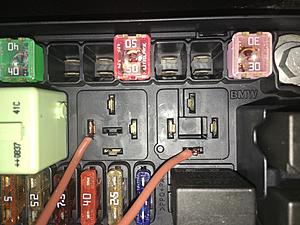

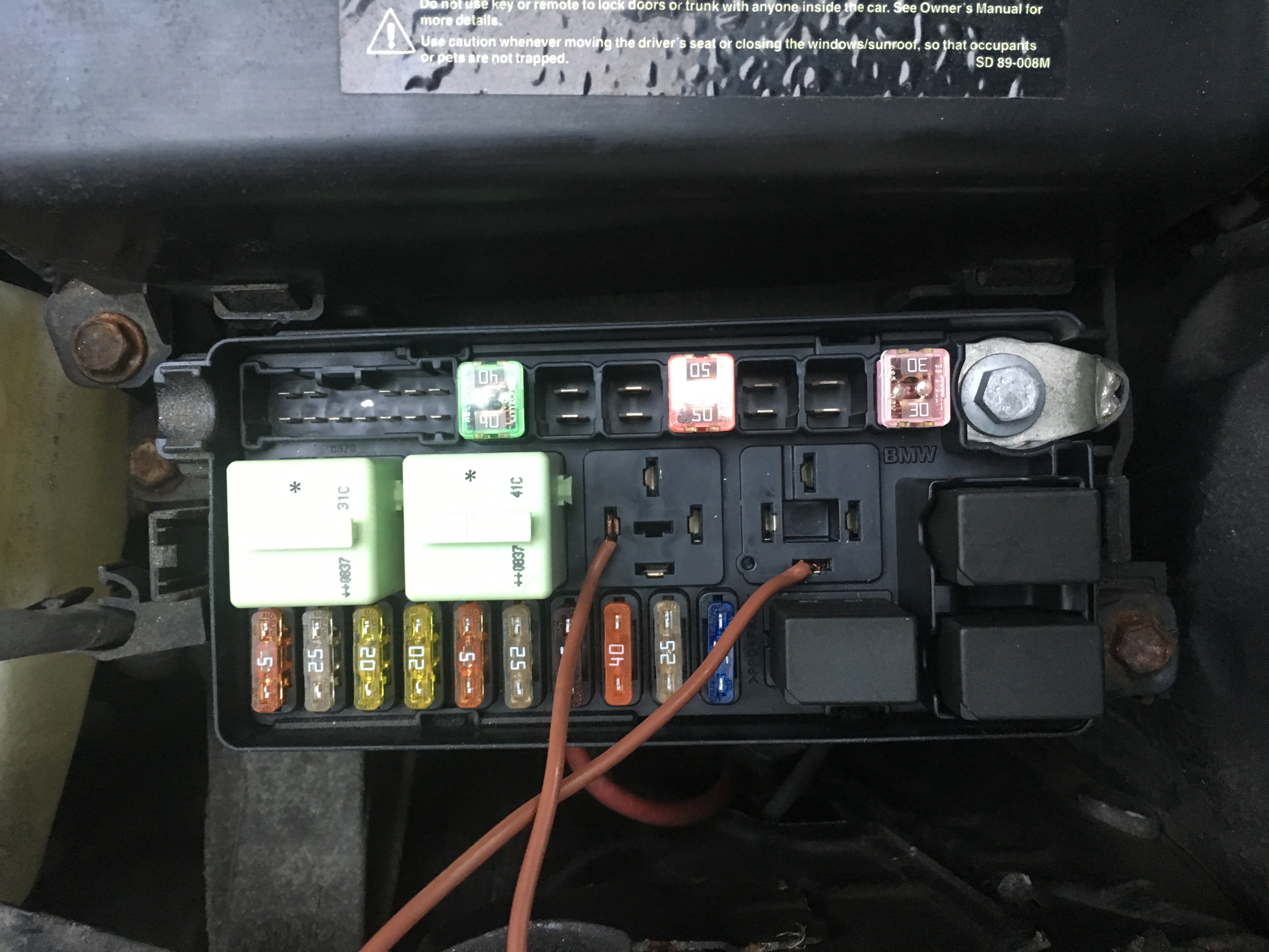

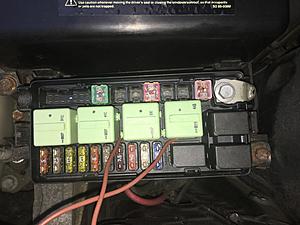

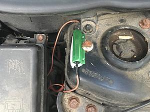

R56 low speed fan - resistor bypass
Seems the R56 has similar problems to the R53 with burned out low speed fan resistors.
I bought the same 100W 0.33R resistor from Amazon that is listed on the R53 thread, and figured out where to connect it on R56 as the wiring is different.
The good news is that no cutting or crimping or permanent soldering etc. to the mini wiring loom is required, it can all be done just by adding two wires in the fuse box next to the ECU.
Photos show the sequence, but basically:
Remove both fan relays
Insert one wire into the low speed fan 12v switched contact
Insert other wire into the high speed fan 12v switched contact
Push both relays back in place, to retain the wire
Use thermal glue to fix the resistor to metal chassis
When the low speed fan relay clicks on, 12v is fed through the resistor to the output side of the high speed relay, which in turn connects down to the fan.
When the high speed fan relay clicks on, the resistor has 12v on both sides so does nothing.
Hope this is useful. Fixed the problem for my 2009 JCW, low speed fan now works correctly when turning on A/C etc.
