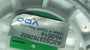

Well i did get into some research into my problem.
test 06.00 shows 8.1 in left tank ( fuel pump tank ) and .08 in right tank )
left tank shows 9 L code 1 ( test 06.01 ) code 1
tank OHM L reads 220.4 right reads 286.0
The Main Discovery I have to thank robbo mcs for giving me the heads up to look for the fuel pumps are both for the R56 Hatchbacks (example autozone pump A2C53378276Z ) it does not list compatible with my 2008 Clubman S.
Next question is there a simple way 2 senders in the mini work correctly for us ?
oh and i thought i would put my pictures sideways because its how this makes me feel!
Attached Thumbnails Gas gauge reads inverse yep BACKWARDS-20180223_211246.jpg   Gas gauge reads inverse yep BACKWARDS-20180223_211402.jpg   Gas gauge reads inverse yep BACKWARDS-20180223_214825.jpg   Gas gauge reads inverse yep BACKWARDS-20180223_215444.jpg
