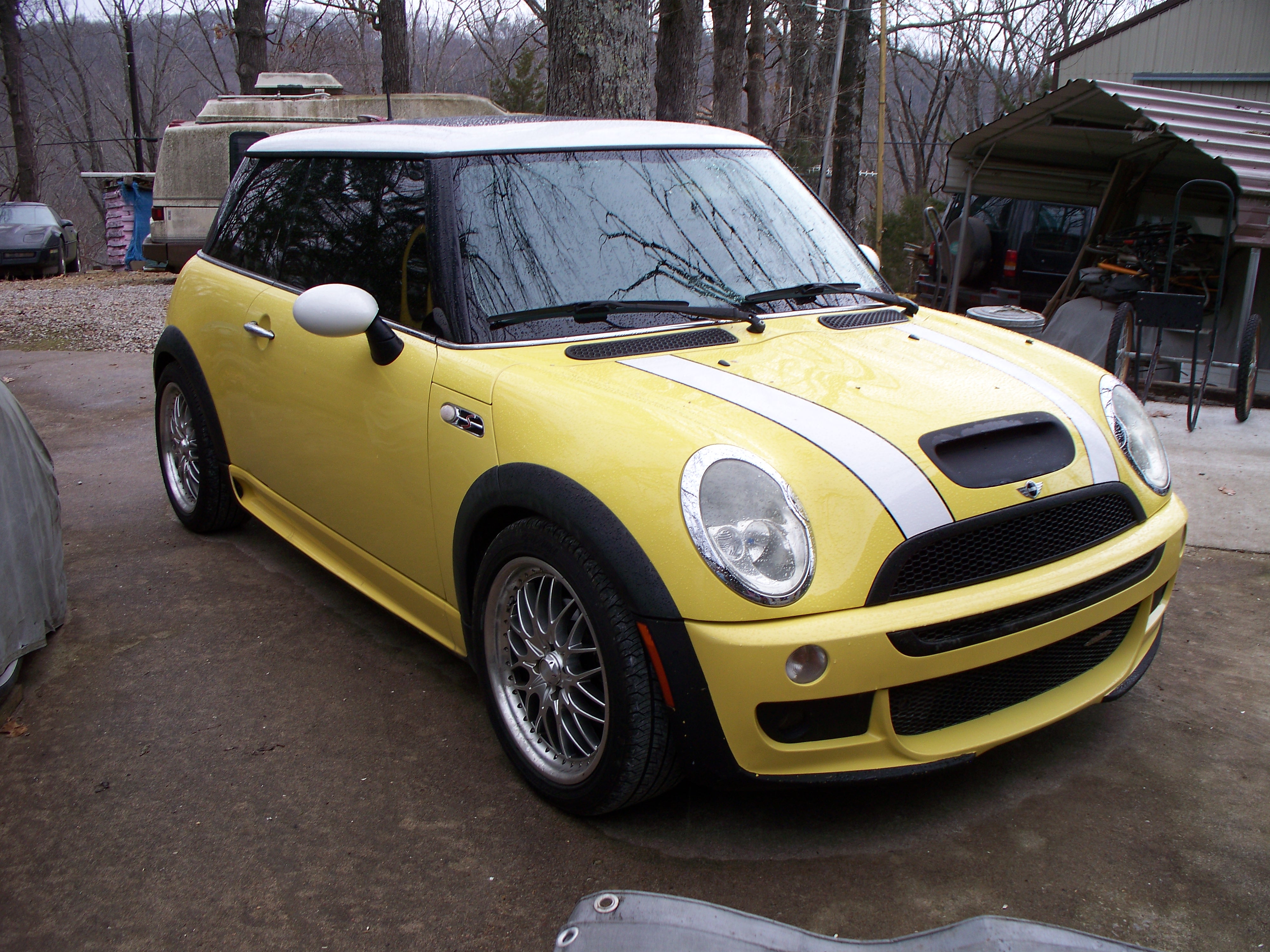

Newbie with a new-to-me 2004 JCW hatch in Liquid Yellow over black.
Been replacing lamps, checking fluids, General cleanup, and learning about my new toy.

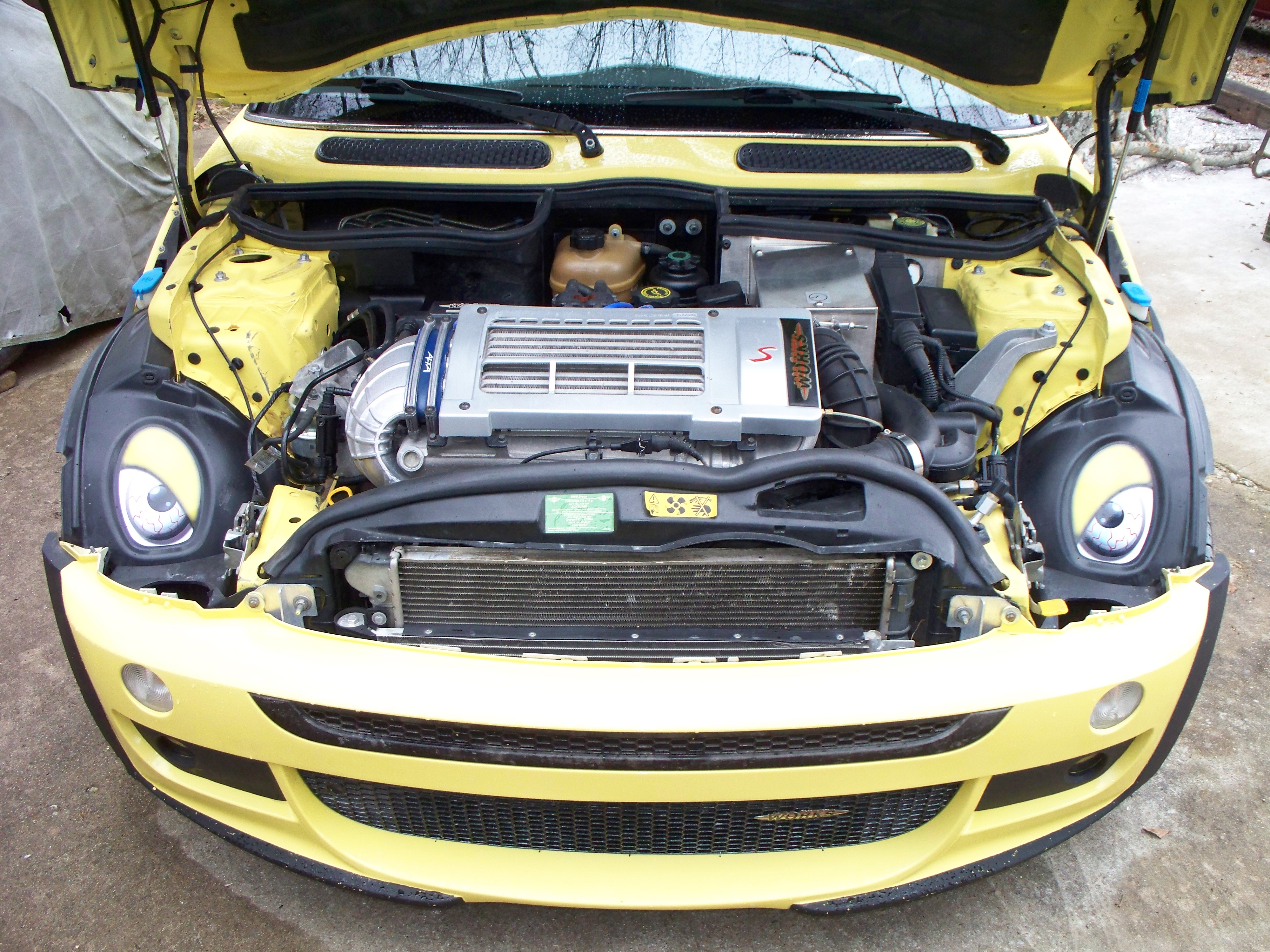

The PO did the following in the last 1-1/2 to 2 years:
New Clutch, Pressure Plate and Flywheel, New Struts, springs, shocks and ball joints, New Radiator Support
All new engine gaskets, New Battery, New belts and hoses, New Belt Tensioner, New plugs and wires
New Supercharger and Water Pump, New Motor Mounts, New Starter, New front axles, New Windshield
New Clutch slave cylinder, New Hood Struts, New Brake Calipers, Alta 17% Undersized Supercharger Pulley,
Alta 2% Oversized Crank Pulley, Alta Intercooler gaskets, M7 Speed Cold Air Intake, Adjustable Short Shifter,
Konig Wheels, Under hood Eyeballs

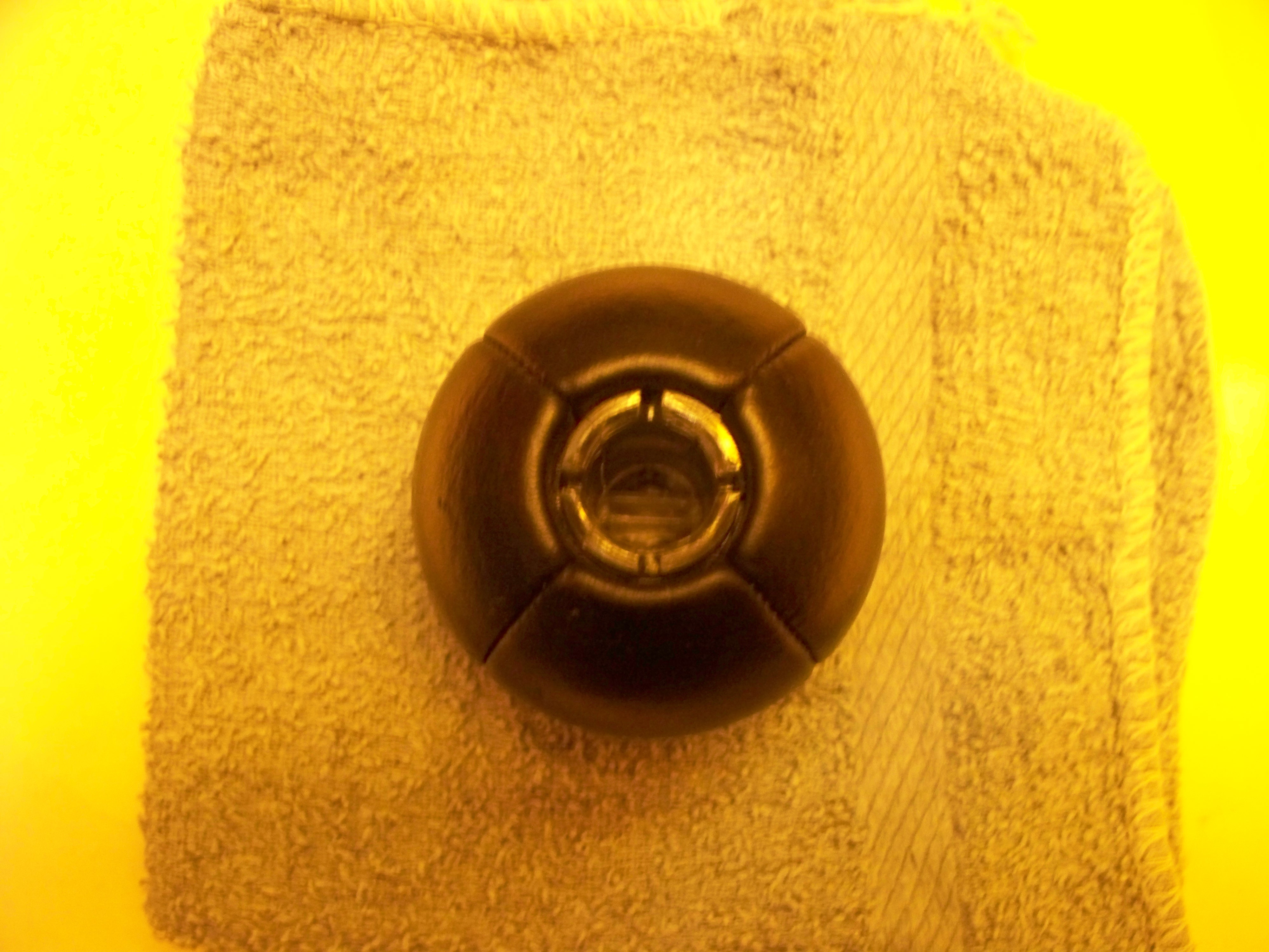

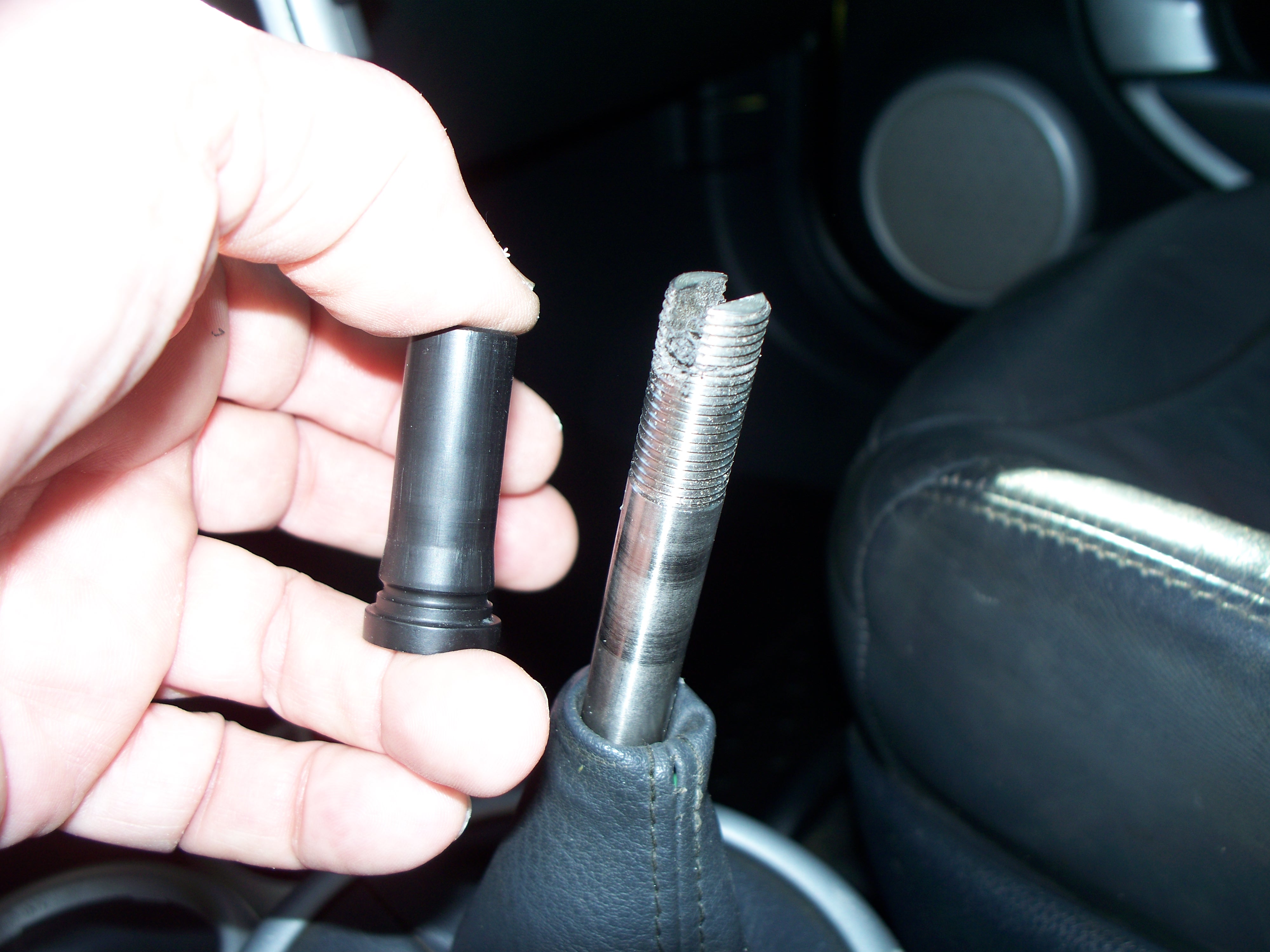

Update: I pulled the shift **** off and discovered the shift lever has a slot in the top and the **** has a blade or pin in the bottom of its hole to engage the slot in the lever. there is a black plastic sleeve that threads onto the lever shaft with a ridge at the bottom that the **** snaps on to. I discovered that the blade or pin in the bottom of the ****’s hole does engage the slot in the lever but turns inside the **** allowing the **** to turn on the shaft. I mixed some JB Weld plastic bonder and daubed it on the ends of the blade or pin in the bottom of the **** hole. I had smeared Vaseline on the shift lever so the plastic bonder would not stick to it, but decided to let the plastic bonder cure in the **** before I put it back on the lever shaft. Time will tell if it will hold, but at least it won't be glued on.
EDIT: The shift **** pin is holding so far in 300 + miles of driving; weather has been too nasty for a high mile test, but so far so good.
