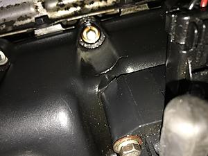

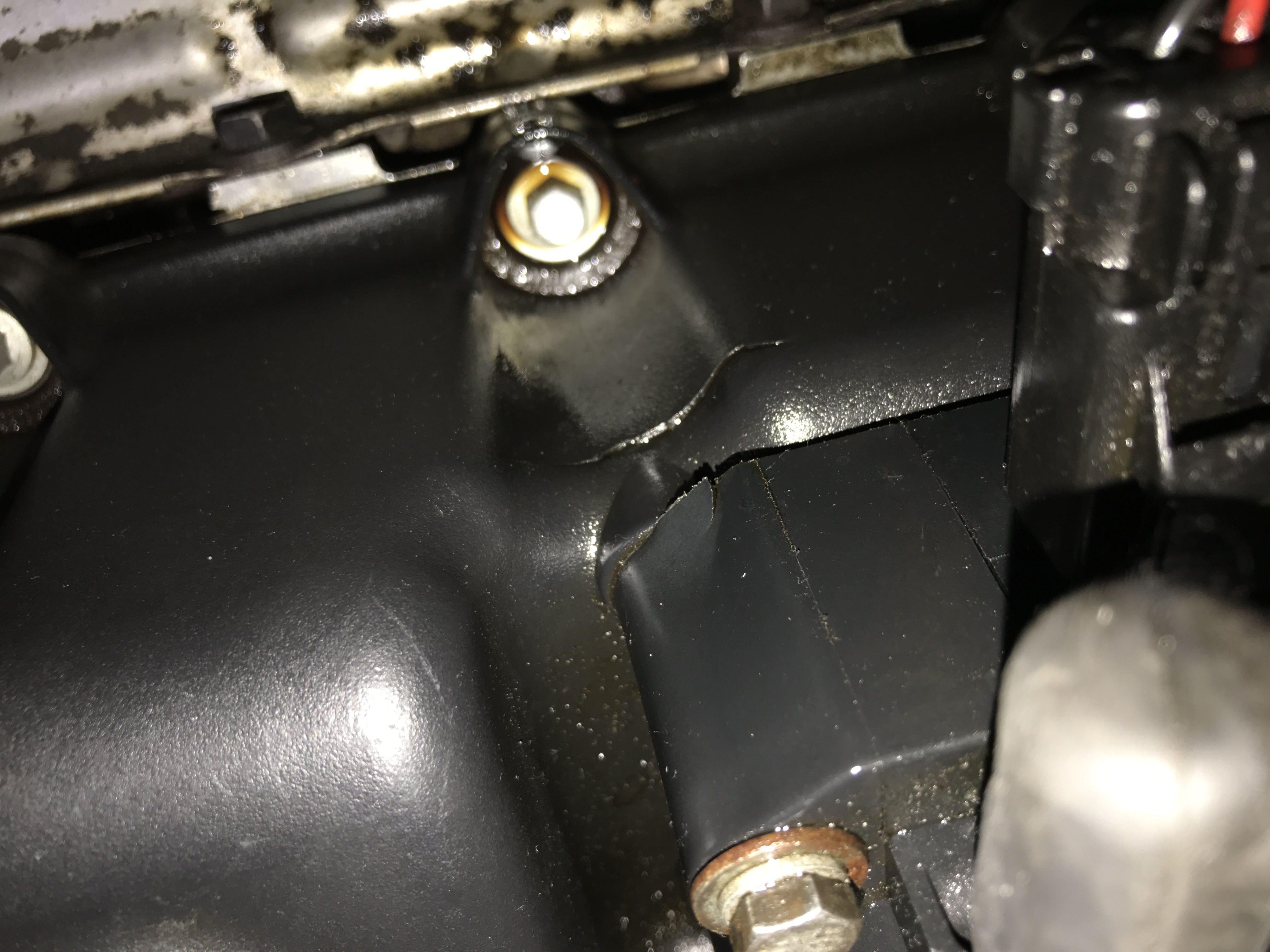

Well...I think I found the cause of my issues. Take a look at the pics.
There is a significant Crack in the valve cover below the ignition coil.
Looks like my shop over tightened the coil and cracked the valve cover.
I forgot to mention earlier that I was detecting some oil residue as well.
What do you guys think?

Old Nov 30, 2017 | 05:43 AM
pnwR53S's Avatar
pnwR53S
6th Gear - NAM Hall of Fame
Joined: Apr 2017
Posts: 3,967
Likes: 393
From: soggy pnw
If the shop was the one who overtighten it and cause the crack, it is a definite sign of incompetence. I would wonder how well they perform the job of "rebuiding" the head, installing it onto the block, and carried out all the needed work to get the engine to proper running condition for a turnkey service.
I reread all you posts, and you never mentioned this job was not done by you. I also see no where you describe you witness coolant leak. The photos are oil leak, not coolant.
If you are sure about the car is running hotter, you need to investigate further. I don't have chrono package so I have no idea where the needle should be. Also since you have to have the head rebuilt, may be you are just used to seeing a worn engine that put out very little power, and hence also very little heat, and you simply are use to seeing the low gauge reading. There are a lot to think about, and there are insufficient information you provided.
There may be other issues with your car.
Old Nov 30, 2017 | 05:44 AM
Posts: 36,766
Likes: 2,553
Yep, you're going to need a new valve cover. New ones come with new hardware and sticker, plus the cap. I would see if they will fix it for you.
https://www.ecstuning.com/News/MINI_R50_R53_Valve_Cover_Kits_25285/
