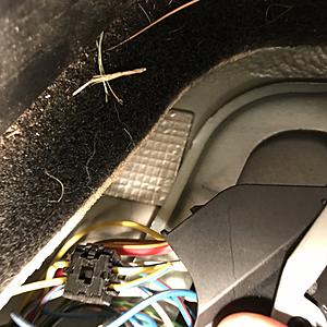

Took my 2010 to a shop with a very good reputation for some engine problems. Long story, but the engine problems were not repairable there.
My problem began when I showed up to retrieve the car at the shop.
The problem at first appeared to be a dead battery. We jumped started the car and drove it up on the trailer, but I noticed that the electric windows did not work.
The service manager said that they had determined that the Footwell module had died. He said that often happened due to moisture down there. Well, the car was dead anyway,so I just brought it home.
Upon testing, the electric windows, heater/ac, and high beams are affected.
Upon examination, the footwell module is dry and clean. No evidence of moisture at all. I did find this. (Picture)
It looks like a loose wire, but I think it is probably the place where the original dealership tapped power for the Oem rally lights they installed way back in 2010.
Following on advice I read on a different thread here, I disconnected the battery, removed the Football Module examined it (looks great), and re-installed it in hopes it would reset.
It did not.
What am I missing?

Rhendy,
I had the battery on my 2010 MCS die on me & it damaged the Footwell Module . While chatting with an electrical engineer at work, he thinks it's probably a design flaw of not enough electrical protection in the components.
I replaced the battery to find the module dead, got it diagnosed, the dealer quoted $1100+ to fix it, I paid the $175 diagnostic fee & took it home. I contacted another local shop that specializes in Minis to do the repair, they quoted about $600-650.
George

chiming in...It is relatively easy/cheap fix. I have been restoring flooded minis for quite some time and this FRM isnt the only module i worked on. So this is first hand experience.
what you need to do is find a module with the same part number or an interchangeable one. use realoem.com to enter the last 7 numbers of the module. there it will show you other modules that can be interchanged with and from what cars.
After that buy inpa, winkfp, ncsexpert, ista/d, and ista/p (not really needed but nice to have) along with K+Dcan obd/usb cable.
also, where are you located?
