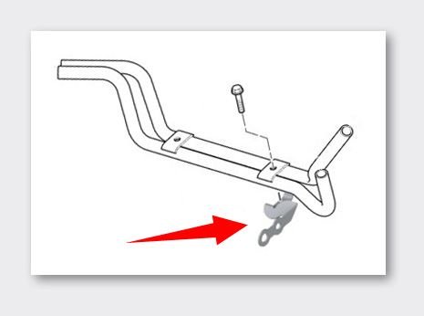

Looking at the part, you'll need to get the car on stands and crawl underneath to figure out how this bolts to the rear underside of the engine (To the subframe? To the block?), disconnect it, fish it out - then replace in reverse order. Sounds easy - outside of the strong possibility of next to no working space, and what might be several components that need to be removed to get to it. But that’s half the fun of working on these cars, right?
Have a look, take a deep breath, and please document your findings and replacement procedure with words and photos, and before you know it, you'll have turned this post into that now missing tutorial which will benefit those who come after you with the same issue.

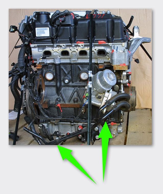

Thanks for the picture. Very helpful! Got the car transported to my house. They are rusted pretty bad. Gonna tackle it on my own, no way to access from the bottom, need to go from the top. I will update this with pictures and a procedure. The rust is from 12 years in lovely Chicago Winters where the roads turn white. Not from the snow but salt

Modmini has a video on changing the oil filter housing gasket and a different one for the starter. You may be able to get to from the bottom and wheel wells. Might be able to remove the clamps from the filter housing (you do not see them from the picture), disconnect the pipes over on the driver side and then pull them out through the passenger side wheel wheel.
I concur. Looks like there's a bracket that the pipe connects to on the driver's side of the pipe assembly. The second hole on the passenger side of the pipe assembly is not connected to anything. Not sure what the bracket is connected to... maybe the block? Regardless, get that one bolt out, disconnect the two ends from the oil cooler side, then the two on the driver's side, then fish it out the passenger side wheel well.

If you don't mine me asking, where did you find that diagram? Maybe my Google skills aren't as good as yours? I started pulling things apart yesterday. I think uncoupling the hoses and backing out the bolt from the top are the only way, and fishing out through passenger well like mentioned will get it. Thanks again for the advice.
Traced it out of a RealOEM cooling system diagram.
The hoses on the oil cooler side are very easy to get to via removing the plastic liner in the passenger wheel well. Not sure on the driver's side. The bolt holding it to the bracket might have to be accessed from the top with an arrangement of ratchet wobble extensions and universal joints - whatever gets you there. I'd give it a soak with some PB Blaster first though, as you don't want to snap it off.
