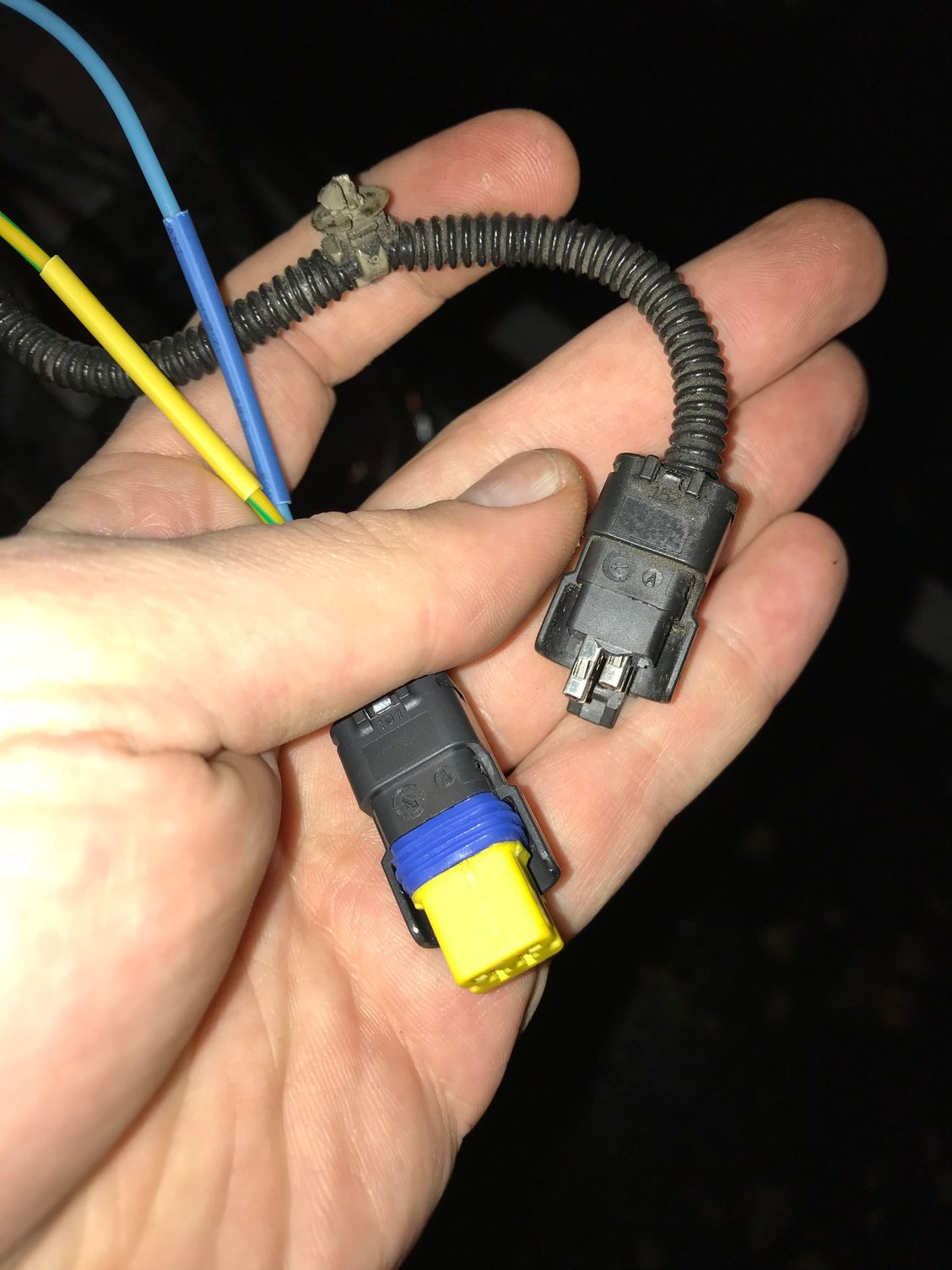

A little follow up on my major issue. Yesterday, I decided to double check the wiring and found out that the exhaust solenoid connector was pretty warn out (no idea how I missed it when I was installing a new solenoid). It actually fell apart when I connected it back in. As the result the error codes switched from p0014 and p0015 to p0013 and p0014. I picked up the new connector and installed it tonight. Let’s see..
