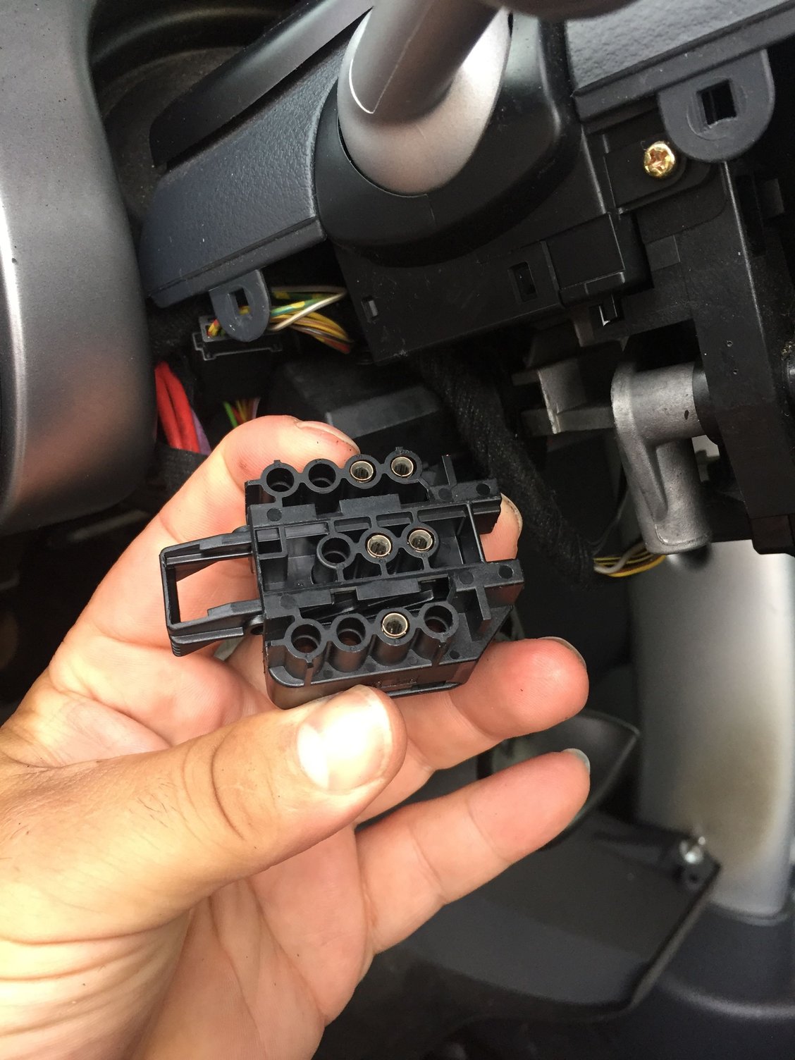

How to change the ignition switch
Remove the steering wheel cover ( lower )
With a small flat screw driver untighten (don't remove) the 2 screws holding the switch
Pull out the switch from his location and pull the side locking tab
Install the new switch and put everything back .
