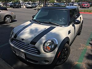

Attached a picture of the car, sad it's not 100% but will slowly get there.
