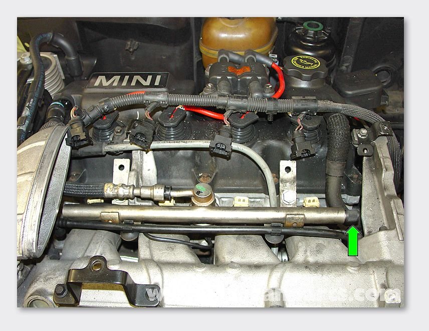

Even if you remove all the old fuel from the tank, you will still need to cycle the stale fuel from the remainder of the system (fuel pump, fuel lines) before your engine will start.
This process should be performed after the car has been sitting overnight, so fuel pressure has subsided. First, remove the intercooler and driver-side intercooler bracket, locate the end of the fuel rail (driver's side), then remove the stem from the center of the schrader valve (you'll need a tool like the one HERE to do this). Then, connect properly sized clear hose to the threaded end of the valve, put the other end of that hose into a clear container to catch the fuel (a large Gatorade bottle will work well), then turn the ignition key to the second click without starting the car (you'll hear fuel pump run for a few seconds, then stop on its own). Repeat this process until your bottle is 1/2 to 3/4 full of the bad fuel. You might have to fill a couple bottles before all the old fuel is purged from your system. You'll probably know the good fuel has reached the end of the line by the color and smell of the fuel.
I'm not positive if simply disconnecting the fuel line from the fuel pressure regulator (at center of rail) and observing a similar process works as well. There may be a check valve of some kind in the end of the fuel hose. Maybe someone else can chime in here.
Good luck.
