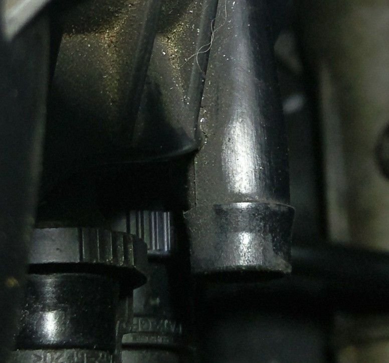

Can't figure out what line coneccts to the open port on the manifold any help would be greatly appreciated

Not sure where on your picture this hose place is?

Sorry it's hard to see just to the right of that screw there are 2 vent lines and a spot for a third but I have nothing to put on it

Nothing. It was without a hose on mine. I don't have any excess hoses and I've taken it off twice. It only has a small hole and I'm not sure it even goes through.
Same here...if I remember correctly, this is plugged internally within the intake manifold.
