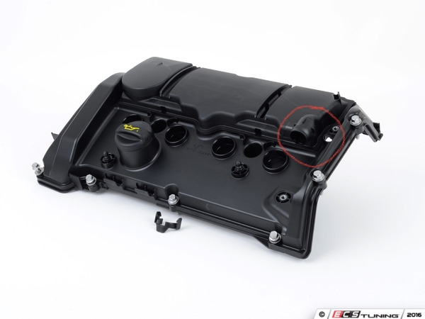

Alright I'll have to check. I did notice that it was a little wet looking around what I'm assuming is a pvc hose on the valve cover. I don't have a pic but I circled where it looks wet on a pic of one.

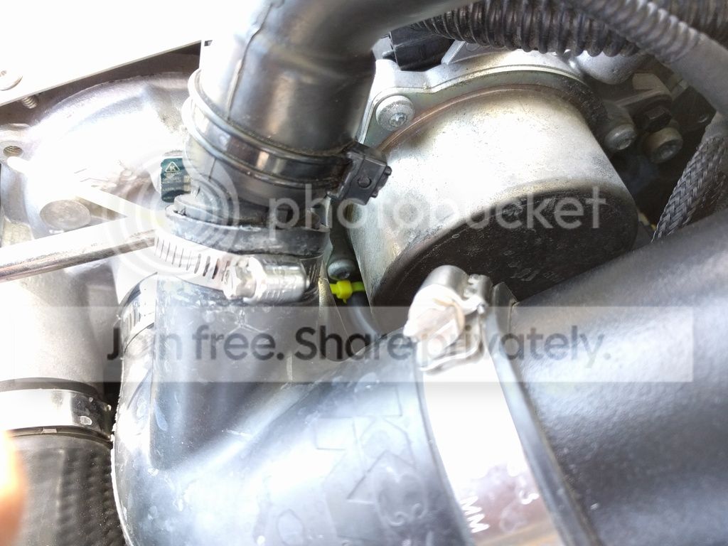

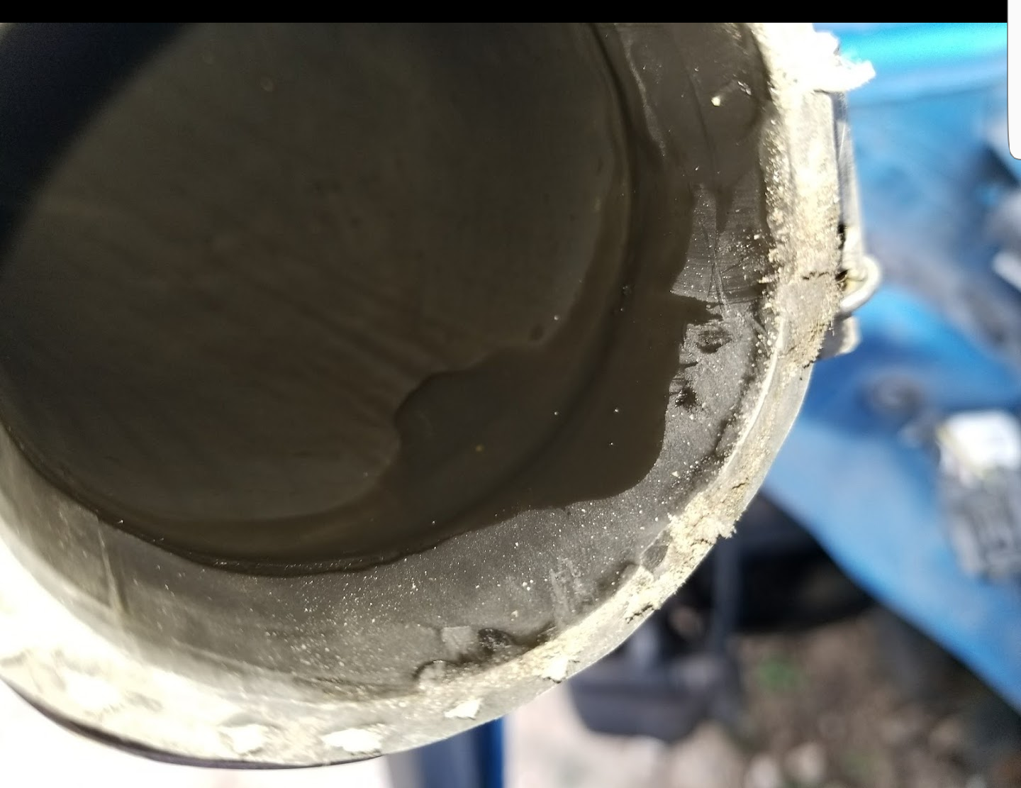

Car has 56k miles on it. Well I couldn't wait till morning so I went out ad took a peak at it. I'm thinking it's pvc related. The port on the inlet tube where the pvc line connects to has a good amount of oil lining the inside wall. Even the electrical plug has oil inside of it. I pulled the tube off the turbo and there was oil residue on the inside wall of the tube right before the turbo. I didn't see oil on the aluminum of the turbo, but that could be from the turbo sucking air and just pulling the oil in. Also there was no play in the wheel I put my finger on it and got no movement other than spinning the fins. Also on the inlet tube there is a port that lookes like a hose is supposed to be connected to but there is nothing around that is disconnected. What's it for?

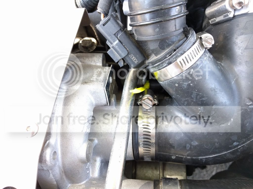

Are you referring to this being disconnected? (yellow zip tie)
no, in the last pic I posted (with the orange screwdriver) next to my thumb. There is a plug and nipple that lookes like a rubber hose or somthing slips over. But there is nothing disconnected from it around it. I'm not sure what it's for, nore do I remember every seeing it ha.

Without an oil catch can, you will see oil at the turbo inlet hose, it is normal.
The purpose of that hose is to provide a path for crankcase vapors to exit the engine when it is under boost. An oil catch can will reduce this, but not eliminate it completely.

Our MINIs turbochargers don't have oil seals, they rely on very close tolerances to prevent oil from getting out of the turbocharger's pedestal bearing.
As Squawskibum suggested; while you have the inlet hose off, give the turbine hub a shake. There should be no play axially or radially.
The amount of oil built up over time, that's why there was less the first time you looked compared to the last time you looked. What is happening is that oil vapor is condensing out of the crankcase gasses at the turbocharger inlet, it will also condense out in the intercooler, that is why you also see oil in your intercooler. Some manufacturers drill a weep hole in their intercoolers to provide a path for the oil to drain out. Others, like Volvo, include an oil catch can in their PCV system from the factory.

So does the n18 engine only have one pcv valve in the valve cover? I only see one, since mine looks wet around the pcv valve on the cover that doesn't mean that it technically bad does it?

The N18 engine has a different head and head cover, the PCV passages to the intake valves are internal, so a hose is not required on N18 engines. They also have variable valve timing on both the intake and exhaust valves, plus the valve timing is different from the N14 engines to minimize carbon build up on the intake valves so N18 engines don't have carbon build up problems like N14 engines do.
The oil leak around your PCV hose is probably just a leaky "O" ring.
