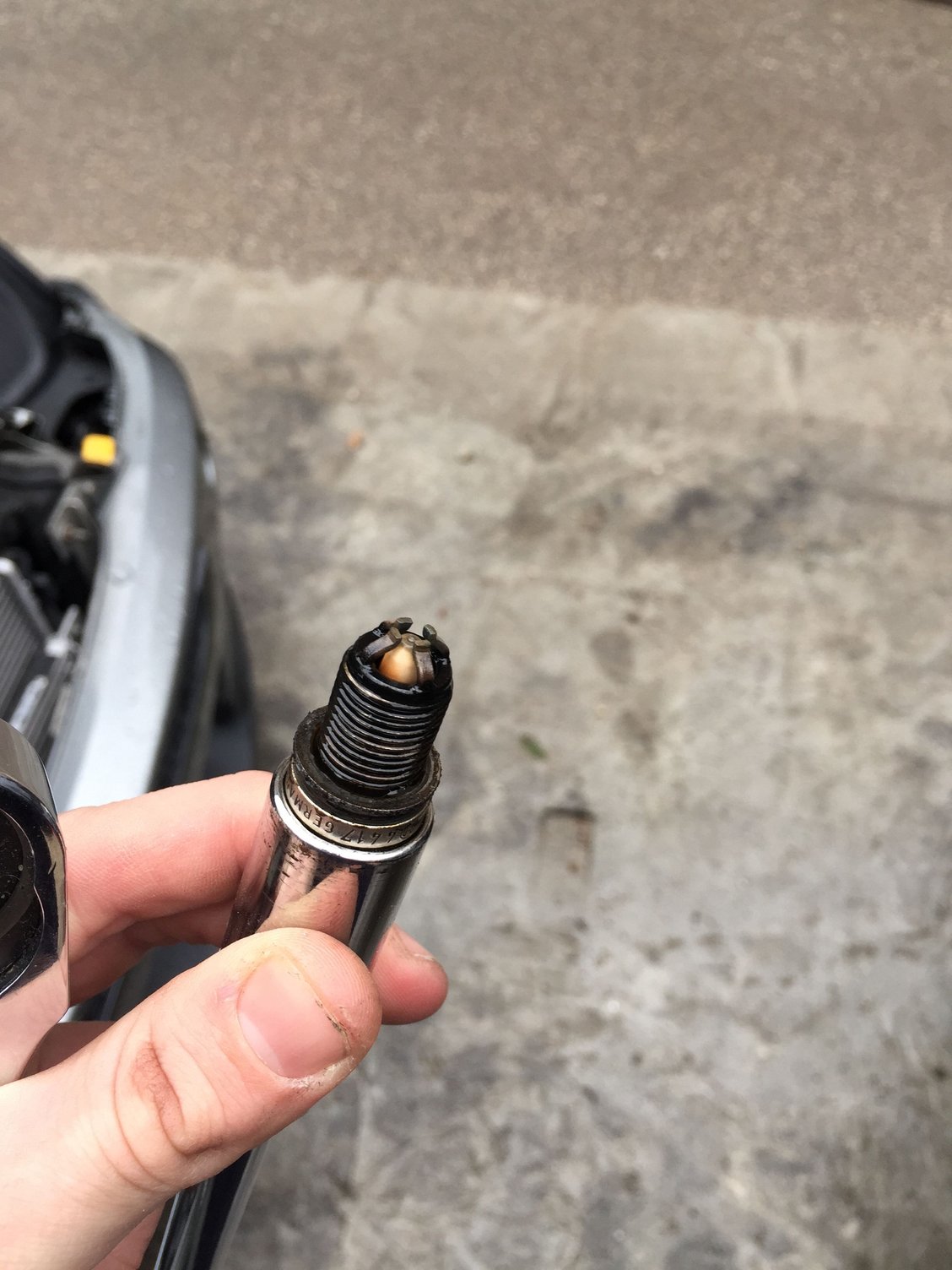

Well there's been a development. I finally got around to doing spark plugs and here's the results. One of these is not like the other:
I guess next time I buy a car I should pull the spark plugs just to eliminate potential huge issues. The PO said he recently did timing chain so I have my fingers crossed that it's something residual from that. Maybe some oil got on the plug or in the cylinder when he was doing it? I'll pull it again after a few hundred miles and see what it looks like. I'm guessing a compression test is in order, too.

Yowza. The plugs look really old. Can't see electrode, but guessing the tips are equally sub-optimal. Slap some fresh NGKs in there.
How'd the plug wells look? Clean and dry?
Lets us know what you find out after the compression test.

Wells looked great from what I saw. This was the tip of the fouled plug. Not sure how much the shop down the street would charge for a test but I'll find out next week when they're open. Otherwise I guess I'll order a tester from harbor freight.

That looks pretty worn. Too bad the PO didn't change the plugs when he had everything already apart!
Is it oil and fuel on the plug? Looks like It wasn't firing at all. Coil okay? plug wire?

Everything looked A-Okay aside from the oil. I think it's just oil on the plug. Coil was clean, wire looks almost new - although they're 7.xmm wires. The coil is MSD and was replaced within the last few years. Maybe I'll toss new wires on there just for peace of mind for $25.
I am thinking the opposite of you. I think the tip looks like it was firing which is making me ever so hopeful it's an isolated issue and won't require pulling everything apart. Plus it hasn't thrown any codes. If it was completely fouled and not firing wouldn't I get a code

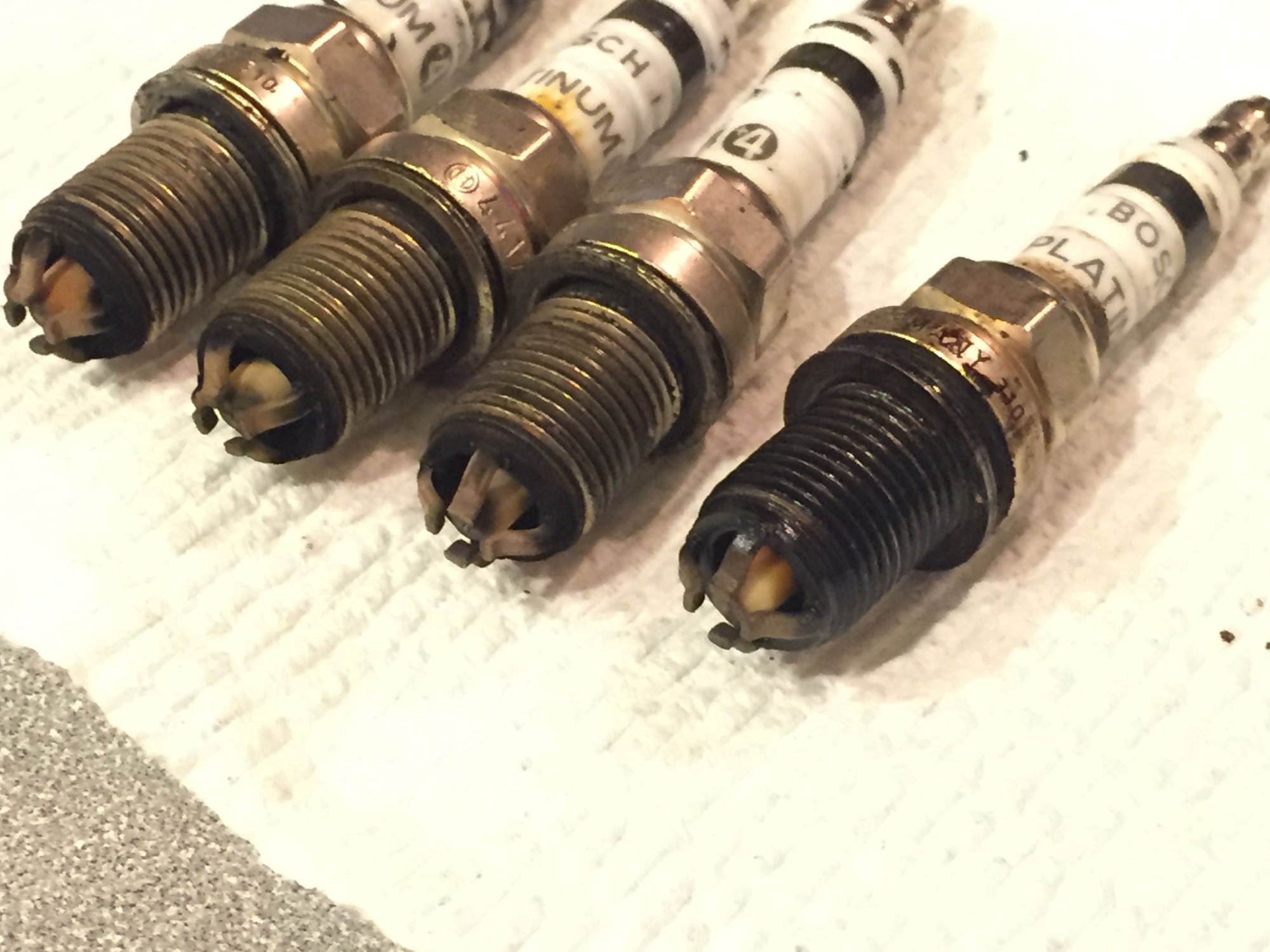

I'll post the rest of the tips in a bit if you guys want to try to read them.

You're right, it is firing, however, it may not be firing consistently. I'm finding conflicting in on whether or not the Bosch Plat +4 (4417) is the right plug for the R53. Saw a couple of threads about this being a better plug for the cooper...
