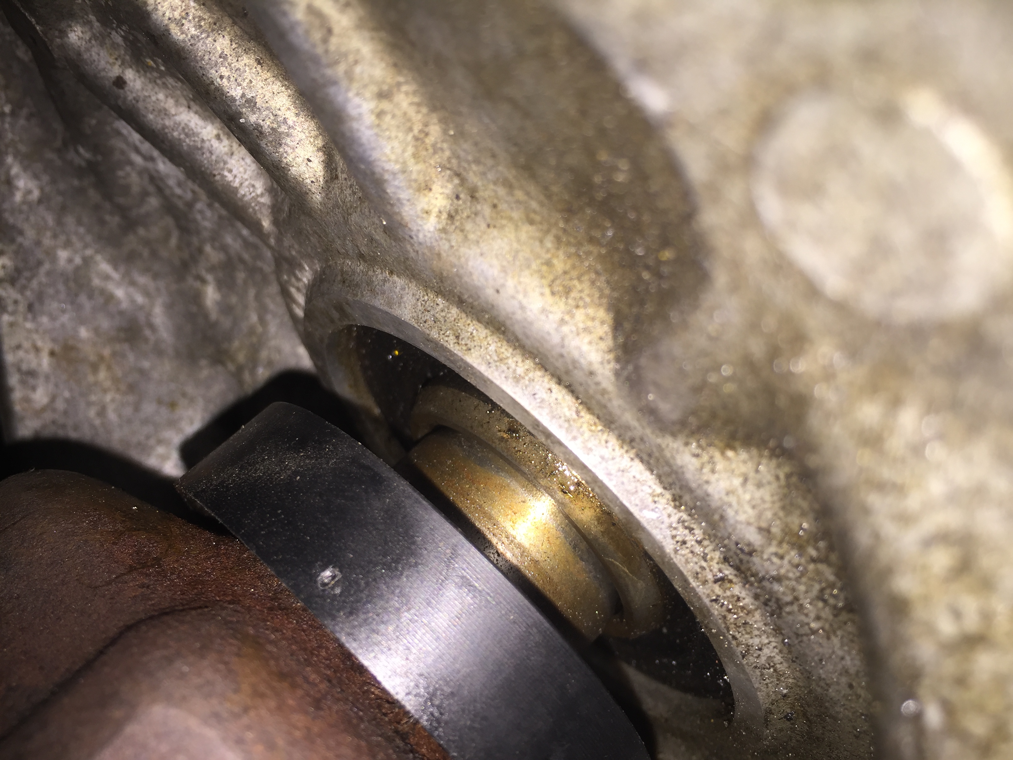

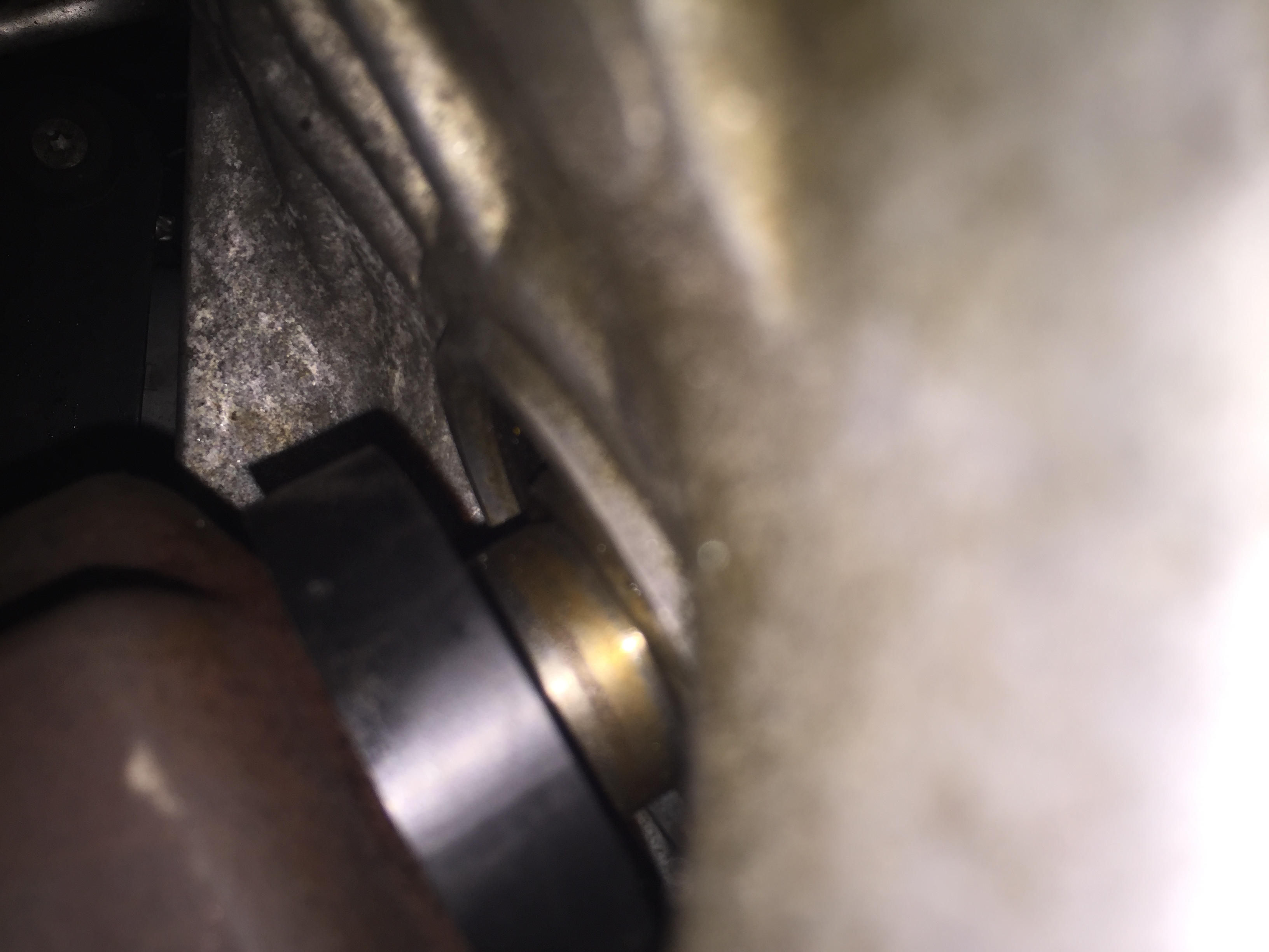

but i have feeling it isnt sitting tight over there .there is no more room i guess but im not sure.i took picture ,thats how its should ??

I just went out and looked at my wife's 2013 R57 Justa auto, and the left axle looks to be pushed further into the trans than the one in your pics. The black plastic-looking circular ring looks to sit flush with the trans on her car. It appears that your axle is not fully engaged into the differential. There is (I believe) a circular spring clip near the end of the splines on the trans side of the shaft that needs to be snapped into the diff gears to retain the axle in the transmission. You will need to pull that left axle again, make sure that clip is there (and has some spring to it), and that the splines are not damaged. Then, make sure it engages all the way into the trans when you re-install. It should take a good firm push, maybe even a couple whacks with a soft hammer to engage it fully. Make sure your trans is topped up, as you may have lost some fluid. Let us know how it goes.

ive replaced that spring clip when i first pulled out shafts including rubber o-ring that sits in differential and shaft seal as well. but it doesnt want to go any futher.thing is when it was loose i was able to pull out without any struggle, very easy. last night when i pull it back, it was very very hard almost imposible to take it out,so i think its in there but not sure :/try to remove it again?

If it seems to be in all the way, leave it in. But in your pics, it sure doesn't appear to be all the way in. Maybe some splines or the retaining ring got damaged? I would definitely keep an eye on it.

+1
the black plastic "washer" can move by the way, so you can push it against the trans.
Usually, when you install the shaft, you should feel the metal hitting when the shaft goes in.
as said before, leave it like that for now since you can drive it. keep an eye on fluids leaking out.
