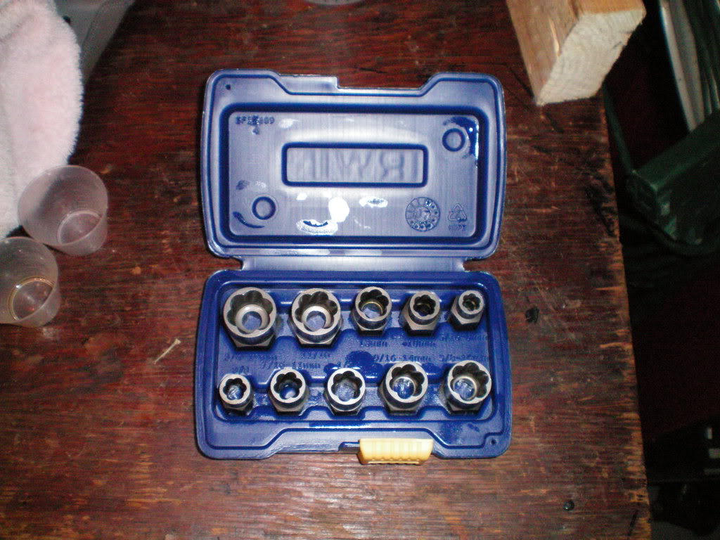

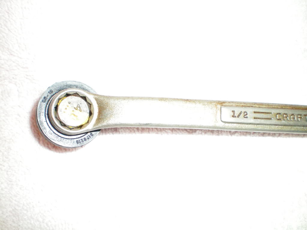

but what were you using to remove the bung?
Despite what all the books say, then GEN1 bung is a PERFECT 1/2 inch .... using the recommended metric often results in what you have as the wrench or socket is a sloppy fit.

I got my mangled out with this (and have done a few for others)

IMO it is that dang plastic seal that is the problem... Fumoto is the way to solve it once and for all. If the oil pan is damaged you could tap it and use an insert then the Fumoto alto just tapping for the next larger Fumoto is cleaner.

@ Capt BJ - My thought is that the pan is damaged at this point, no confirmation on that though. The gasket is factory original with 138K miles and is leaking so it needs replacing anyway.
I did try the sockets shown in the blue case. They didn't work either. Changing out the pan is my last choice and will ask the shop to avoid it if at all possible.
