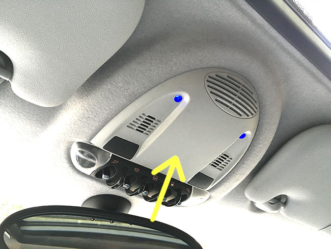

irritating trembling noise
On some roads where the asphalt is a little harsh, i get small vibrations and the specific plastic ive attached a photo of makes an irritating trembling noise. If i squeeze gently where the arrow is pointing at, the noise stops, so i was thinking that maybe it isn't well fixed and thats why the noise occurs. Maybe removing it a adding a little of silicone could fix the issue, the question is how do i remove it! Anyone know or has seen a video with a how to removal?

Old Jan 28, 2017 | 09:14 AM
Minnie.the.Moocher's Avatar
Minnie.the.Moocher
Joined: Jun 2014
Posts: 5,391
Likes: 576
From: earth PNW
Looks like it prys off with a trim removal tool or plastic paint scraper. Check diagram for your car at realoem.com for any screw locations to be sure.
Old Jan 28, 2017 | 07:39 PM
ceoengr's Avatar
ceoengr
Joined: Feb 2010
Posts: 141
From: Texas
Just pull from the edges and it pops out. Behind there is a speaker for the blue-tooth and a few wires. Check if they are loose and or rubbing. I shoved some foam pieces in there and snapped the trim back. This stopped the vibration emanating from this area.

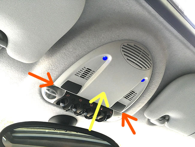

Which edges are you referring to? Can you show by putting some arrows, im afraid i might break it.
Old Jan 29, 2017 | 05:10 PM
ceoengr's Avatar
ceoengr
Joined: Feb 2010
Posts: 141
From: Texas
The edge of the trim where it meets the headliner on the driver, passenger, and the rear side. You may feel some initial resistance and that is normal. PS - Sorry it is not possible to draw arrows using S7 phone.

the edges?
No worries about arrow drawing, ive put them in the picture in orange color. Please verify that the arrows point to the "edges" you are talking about!
Old Jan 30, 2017 | 02:05 AM
ceoengr's Avatar
ceoengr
Joined: Feb 2010
Posts: 141
From: Texas
Yes.
Old Jan 30, 2017 | 05:08 AM
genik's Avatar
genik
Joined: Nov 2007
Posts: 909
Thanks ceoengr i tried it but its not just the gray plastic part that can be moving causing the trembling noise, even the black in the inside is wobbly! And thats just not it, its not easy to place foam (or else) to make it stiffer because it just wont "button up" to the black plastic part when pressed, theres not enough room to make this move. I couldn't put any foam or anything else, i only screwed more the screws and prayed. :-)
Where did you manage to put the foam anyway?
What do you mean by foam, a spray?
