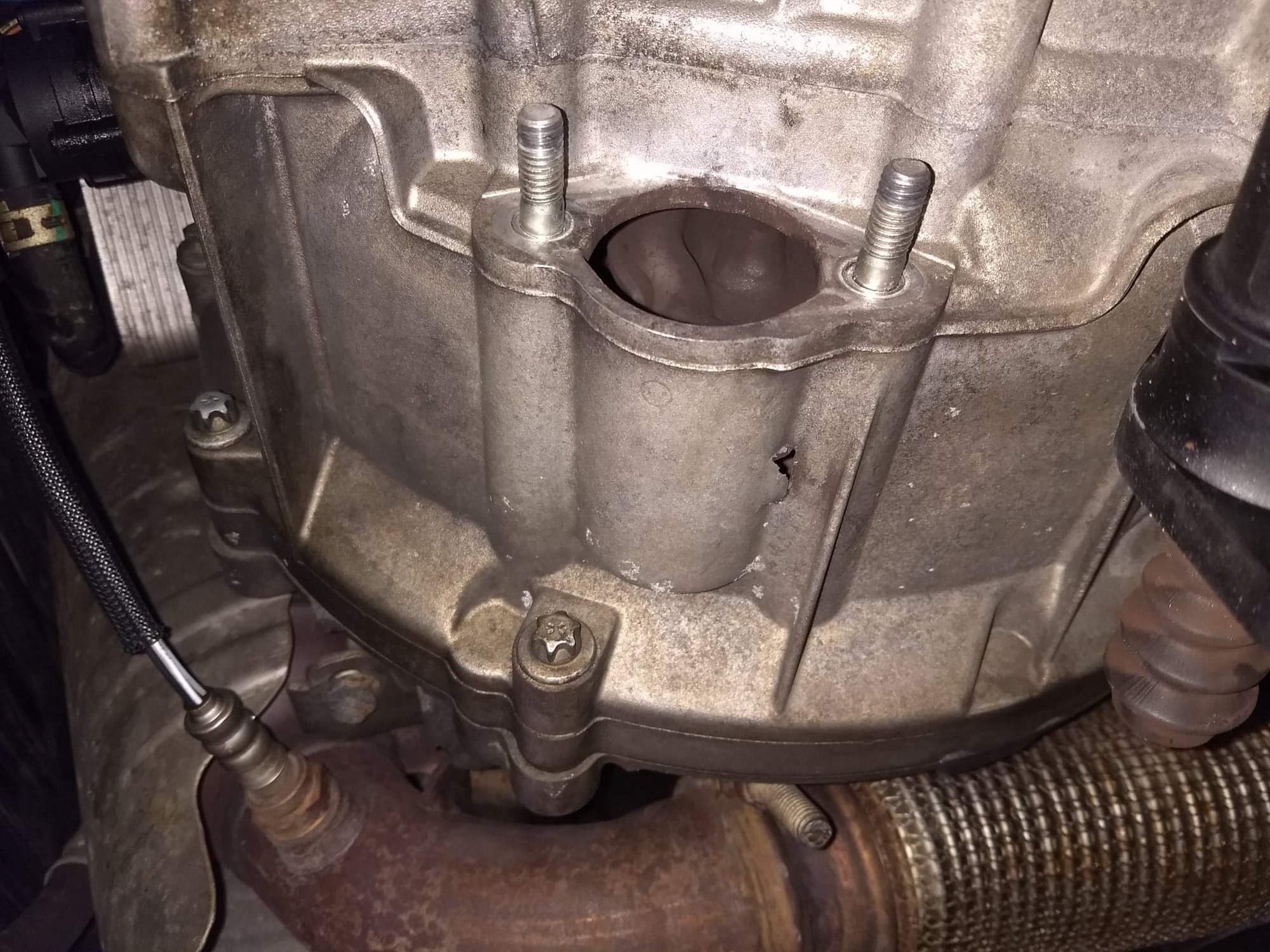

Thanks for the explanation. Sounds like the same problem I am having. Do you have any pics of the failed parts or P/N's? I just pulled my slave and took some pics of the fork and case wear. Did it look like this? Offset clutch fork
Trans case wear

Well after studying diagrams and pics online I think I understand what is going on here. As the OP suggested the fork slipped off the Pressure Pin, item 2, p/n 23-11-7-545-084. See diagram attached. I was able to persuade my fork back onto the pressure pin using a prybar however it looks like there is a wire clip/spring to hold the fork onto the pressure pin to keep it from popping off. See diagram and pic. I wouldn't be surprised if my and the OP's spring missing or damaged. My slave cyl developed a leak in the process. I'm hoping re-seating the fork and replacing the slave will buy me some time so I can save for a new clutch before dropping the trans. Updates to follow...

The pressure pin was intact and functional on my car. The clutch arm actually slipped on the throwout bearing. I will try and upload a picture when I get home tonight. That is the same spot that my case was worn at but mine was not all the way through as yours is.
Sean
Cracked and damaged throwout bearing
Source of awful noise, the clutch arm hit the clutch here
Groove in transmission housing due to damaged throw out bearing
