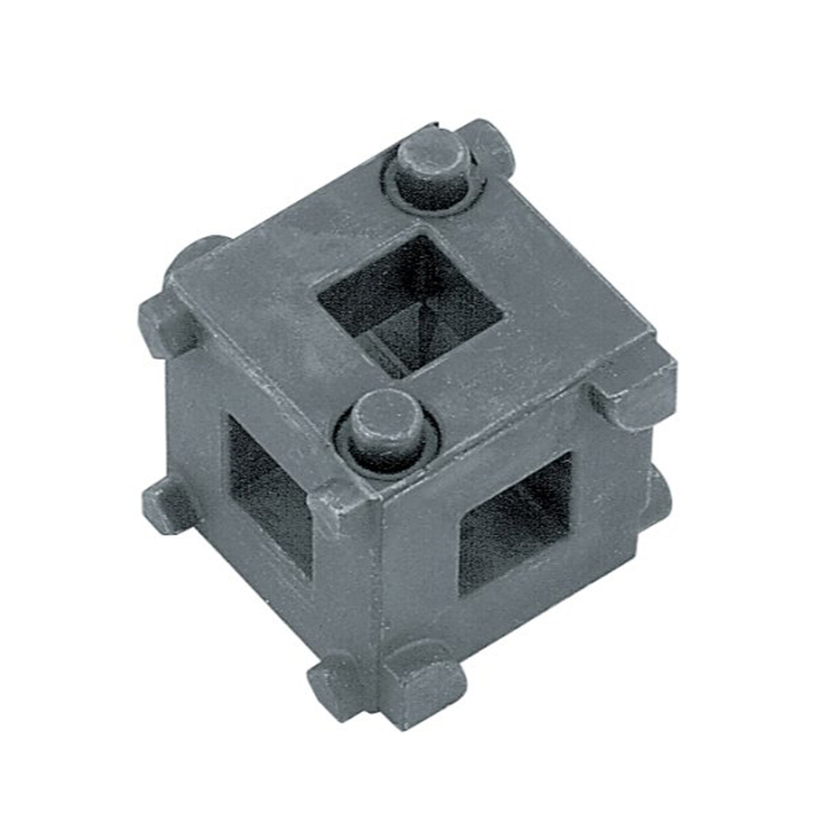

Rears - I watched a youtube video from Mod MINI and he talked about the need to push and turn the rear piston. Hondas just require a turn. Looks like another tool...

The rears do require a 'push and turn' which is easier (in the opinion of some) with a proper tool. This system is FAR from unique to MINI however. My tool for this came with a dozen adapters to fit different makes .... I don't recall if I needed it on my last Honda job but it is easy to tell. If the caliper needs to be turned there are typically holes for the tool to fit in to! If you don't know what I refer to, I suspect your Honda did not need - OR you successfully got away with not doing it - which IS possible too. I usually find a car specific DIY on line b4 I begin to verify . . .
