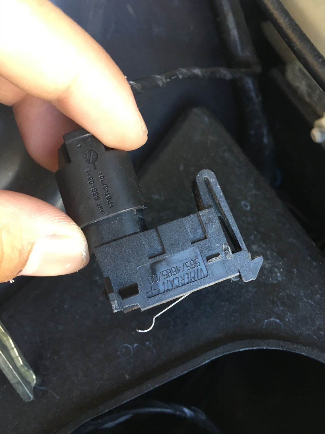

Can anyone identify where this plugs into?
Wiring harness is along the passenger side motor mount .

Looks the switch that checks if the hood is open or closed. Should click into the right (us passengers side) hood latch.
If you don't have that switch in place, I can post a photo of how it fits

David hit the nail on the head. It is indeed your engine hood switch, #6 below.
