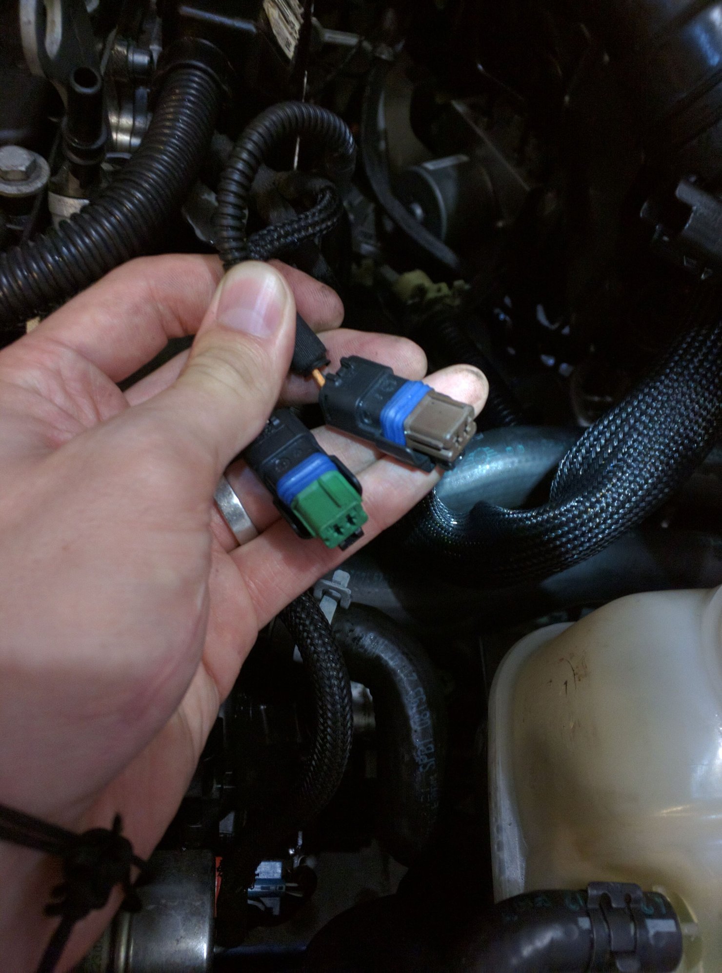

Checking electrical. Here are the only two connections I could imagine getting mixed up. I've been connecting the green one into the cts, the brown one has been connected to the air near the turbo. Correct?
Tugged on the back t'stat connection - didn't come loose. I'll reconnect all of these though.

Quick Update.
Disconnected & looked over the couple electrical connections.
For me at least, there was no way to swap the green and brown plugs ( I tried ).
The back one looked good - replugged it in.
Car's idling with heat on Hi, max fan speed. Blowing hot air. So far no air from T'stat bleed valve. The coolant in the expansion tank has risen a little bit very slowly.

Quick drive around the block. Heat still on max temp and fan.
CTS reading went from 83c to 90c pretty quick. Pulled back in the garage, opened the expansion tank cap, bled from the t'stat housing and only got coolant.
Coolant level went up another 1/4".
Old Aug 20, 2016 | 10:01 AM
  #48
Halfphild's Avatar
Halfphild
Joined: Apr 2015
Posts: 42
From: Mckinney, TX
Update.
Getting no air from bleed valve, only coolant.
Heat blows realy hot.
Coolant level has risen to about a half inch above max.
For kicks, I turned on the ac max.
cts reading jumped from about 87c to 101c and a fan turned on (didn't sound like stage 2)
Turned everything off, cried a little and am currently looking for emotional food.
Thanks for any help guys.
Old Aug 20, 2016 | 10:14 AM
  #49
oldbrokenwind's Avatar
oldbrokenwind
Joined: Mar 2011
Posts: 1,945
Likes: 203
From: Northern NV
As for swapping connectors --- mine is currently completely dis-assembled so I can't easily verify which one goes where. My original swap was the coolant temp sensor with the connector on the PCV port at the turbo inlet heater. Everything was all apart, I just didn't label things, and made a bad choice during re-assembly. It threw a coolant code, so if you aren't getting a code, you probably didn't make this mistake.
Are you certain your t'stat hoses are connected correctly? Could you have an input hose connected to the output? Not sure it even makes a difference --- just a SWAG!
Old Aug 20, 2016 | 10:36 AM
  #50
Halfphild's Avatar
Halfphild
Joined: Apr 2015
Posts: 42
From: Mckinney, TX
I think everything's hooked up correctly. I've done it now three times. But I don't have access to a code reader.
The only code the dealer received while diagnosing it was a faulty CTS. But I've replaced that twice since then haha
Expansion tank gets super hot btw.
Should I take it to a shop, non dealer, around the corner? Have them try to flush out air...?
