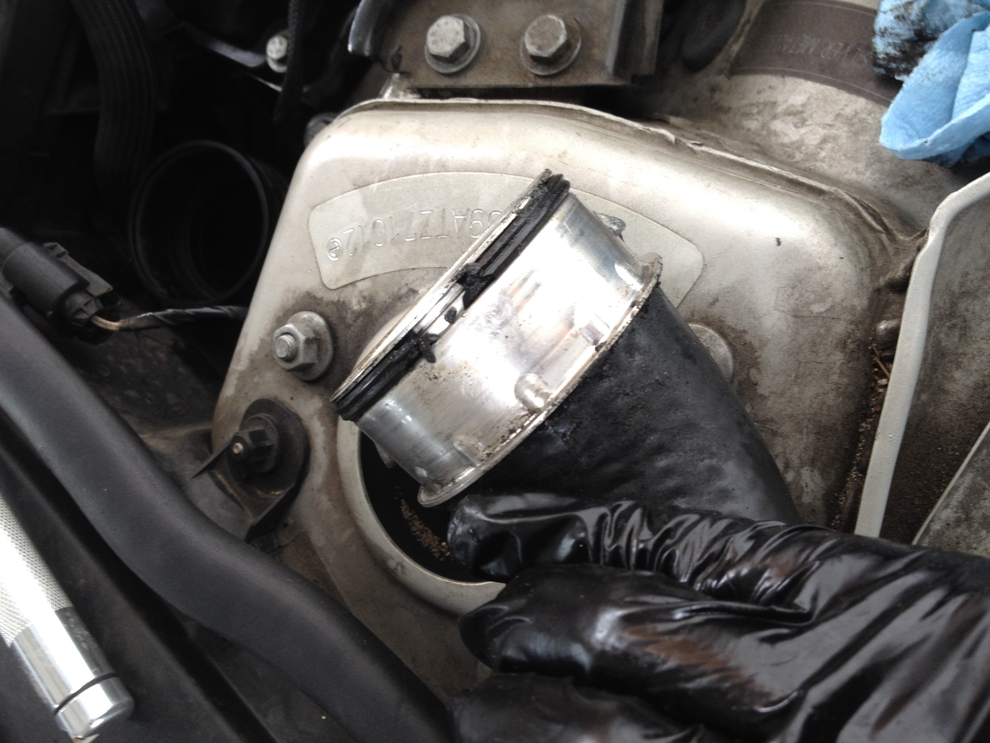

Hi all, long time since posting but I have an issue and would like your opinion/input. I don't know what is the name of the part, if I need to replace, or if I just need to replace the gasket ring #20
Thank you in advance!

found it, it is the gasket ring p/n: 13718642146

Looks like you got it handled. Pretty cheap part. Can buy it here.

That's a lot of oil in your intake tract, your running a OCC correct?

That the ring, make sure you clean up the residue oil while you are there.
